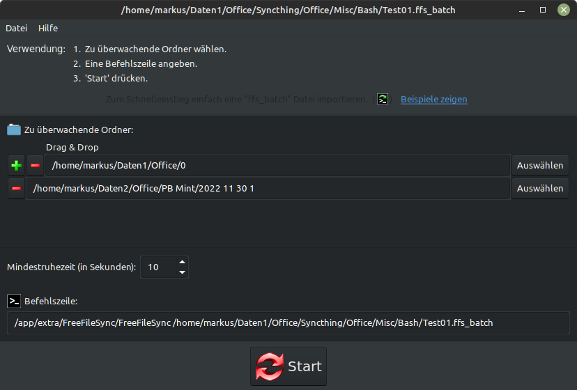

I have a batch file which I can run manually and it syncs my two folder, that's fine...
When I drop it into RealTimeSync it fills out the lines and when I start RealTimeSync it is shown down below on the right but it doesn't sync changes...
What can I do to check what's wrong?
RealTimeSync is not syncing

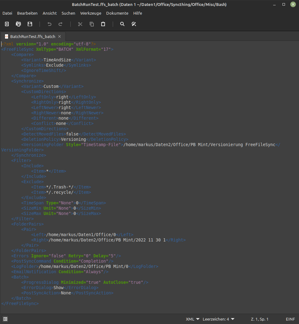

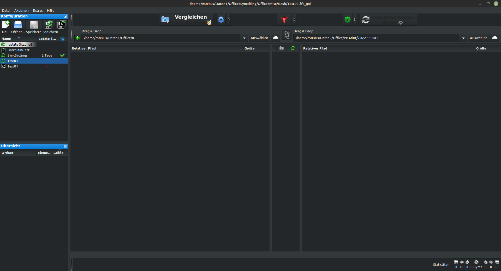

The last time I tried to make it working I could klick on the batch manually and it was syncing but that doesn't work anymore so I can only use FreeFileSync, not the batch file and not RealTimeSync...
I did all the same way as they show you in the YouTube vids...
Hope the attached files are ok?
If you aren't able to double-click the ffs_batch config to run it, it may be worth remaking it from scratch to see what happens. Maybe ffs-batch files aren't registered to open with FFS for some reason?

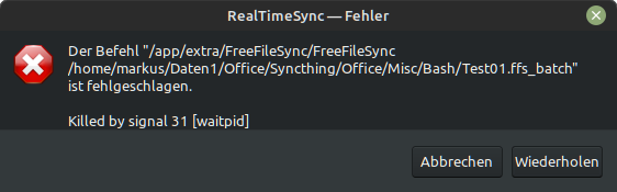

Finally RealTimeSync made up an error message...
I'd suggest running /app/extra/FreeFileSync/FreeFileSync /home/markus/Daten1/Office/Syncthing/Office/Misc/Bash/Test01.ffs_batch from the terminal. Perhaps the app is crashing, and the terminal might show some useful info: signal 31 = SIGSYS = Bad system call

Shouldn't I run RealTimeSync instead of FreeFileSync in the Terminal?
Because FFS is running fine, it's RTS that's not running at all...
When I run the code you provided the I get a message "didn't find the folder"...
This is just as a test. RTS makes the same call.
