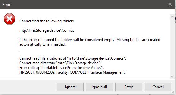

I'm getting a strange error when trying to compare two folders of comics, one on my NAS (which is fine) and one on an SD card in a FireHD tablet, mounted on Windows 10. The error is below:-
Cannot find the following folders:
mtp:\Fire\Storage device\Comics
If this error is ignored the folders will be considered empty. Missing folders are created automatically when needed.
___________________________________________
Cannot read file attributes of "mtp:\Fire\Storage device\Comics".
Cannot read directory "mtp:\Fire\Storage device".
Error calling "IPortableDeviceProperties::GetValues".
HRESULT: 0x80042009, Facility: COM/OLE Interface Management

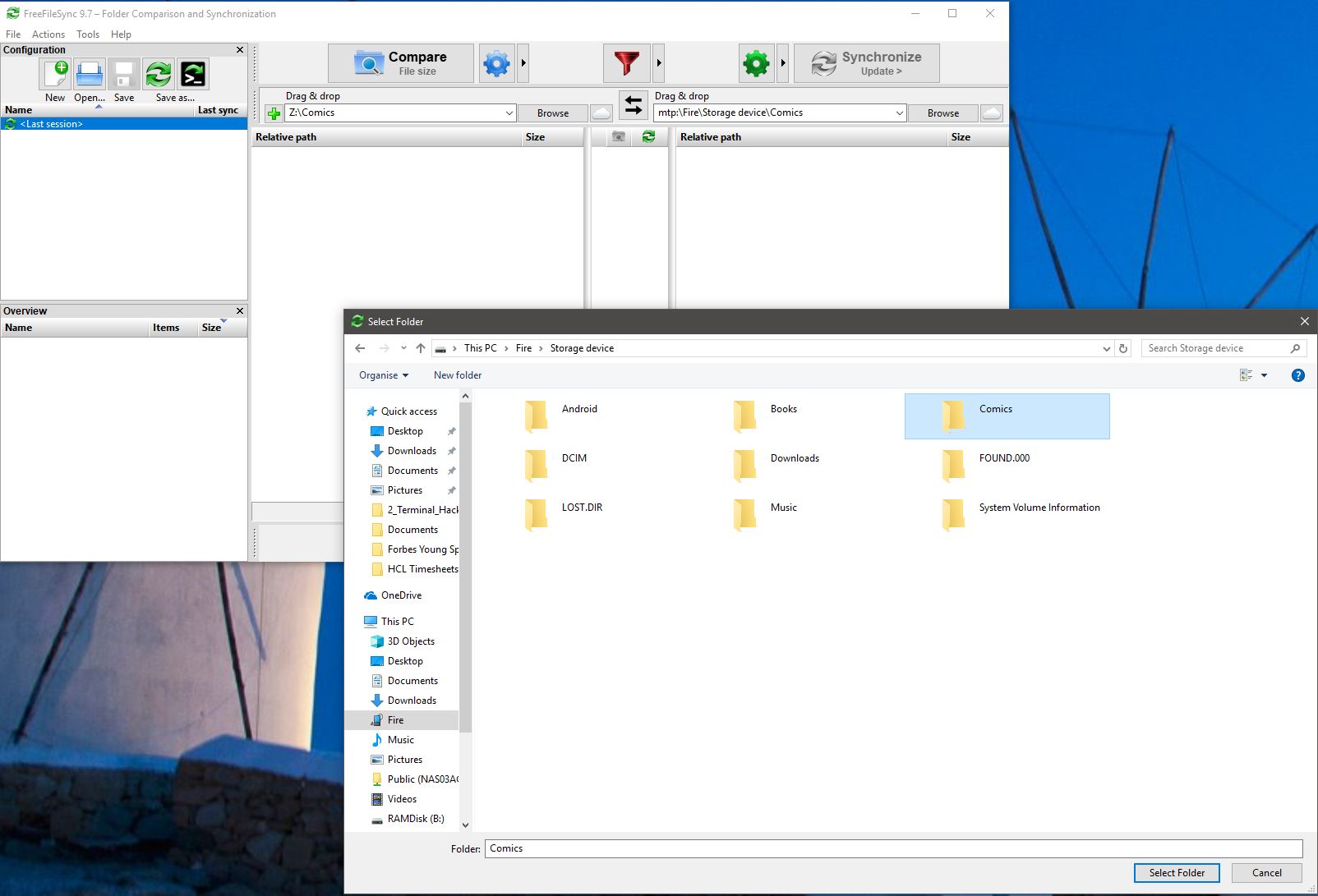

I can browse to the folder just fine, so FreeFileSync can read it, it just fails when I try to compare them.
I'm also running the latest version (9.7 Build 19/01/2018 - Unicode x64).

Yes, it happens ever time. I've screenshotted below, so you can see I can browse to it in FFS, but it doesnt "see" it when trying to compare.

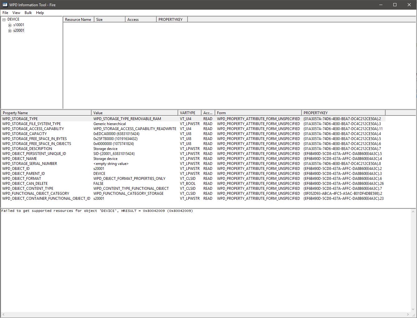

I'm suspecting that there is an error of some kind which Explorer simply ignores. Here is the WPD tool that gives a low-level view on the MTP device: https://www.mediafire.com/file/esuors6i88u1ahf/WPD_Tools_32-bit.rar
Can you browse to the "Storage device" node via "wpdinfo.exe" and report which items it shows there?

Image attached, I honestly don't know what most of it is telling me, but the error at the bottom is interesting.. I've removed the SD card and tried it with a USB adapter and it works fine, which suggests the FireHD isn't presenting it correctly to Windows.
Either way, its a tablet/windows issue, not a FreeFileSync issue. I'll just remove it and plug it via USB when I need to sync in future. Thanks for your help. :)

It would be interesting to see what happens when you expand the node "s20001", which is essentially where the error occurs for FreeFileSync. It should contain at least the 9 folder shown in your earlier screenshot, but maybe some other useful info, too.

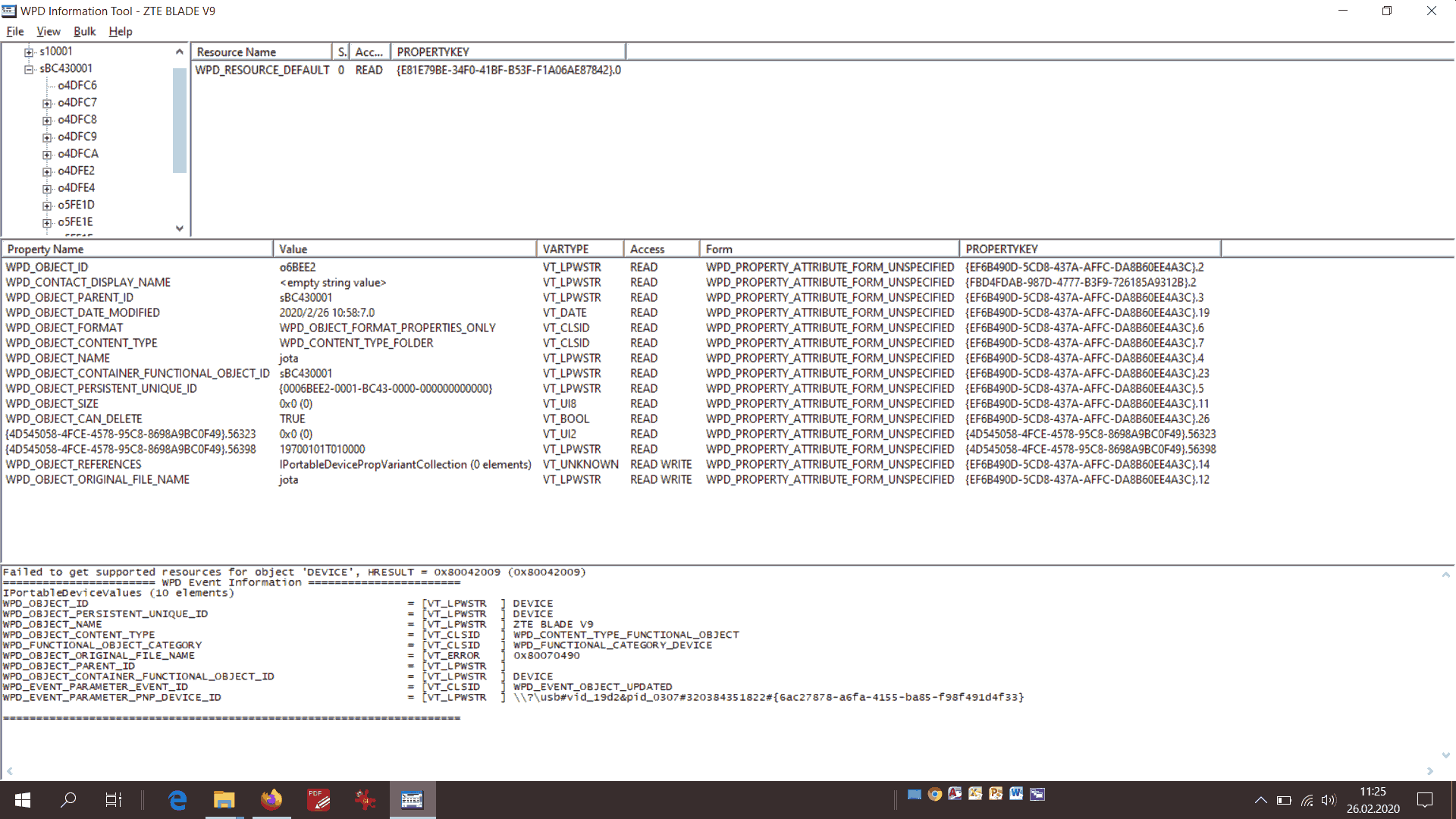

Can you post the item properties (full screenshot) for ".jota+" in the WPD tool when the file is causing folder read error in FreeFileSync?

Sorry for the delay. I am not at home and only occasionally can use my PC.

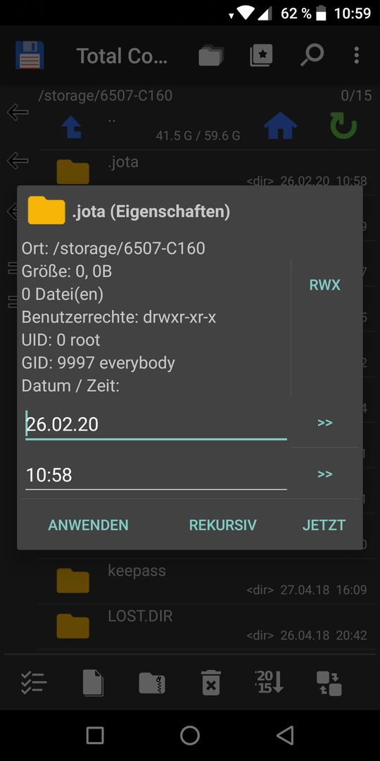

I created the folder ".jota" with the android app "Total Commander".
Screenshot of what Total Commander shows as folder properties:
Following, wpd-info of the folder ".jota":
And wpd-info of the folder after renaming it to jota (without dot):
