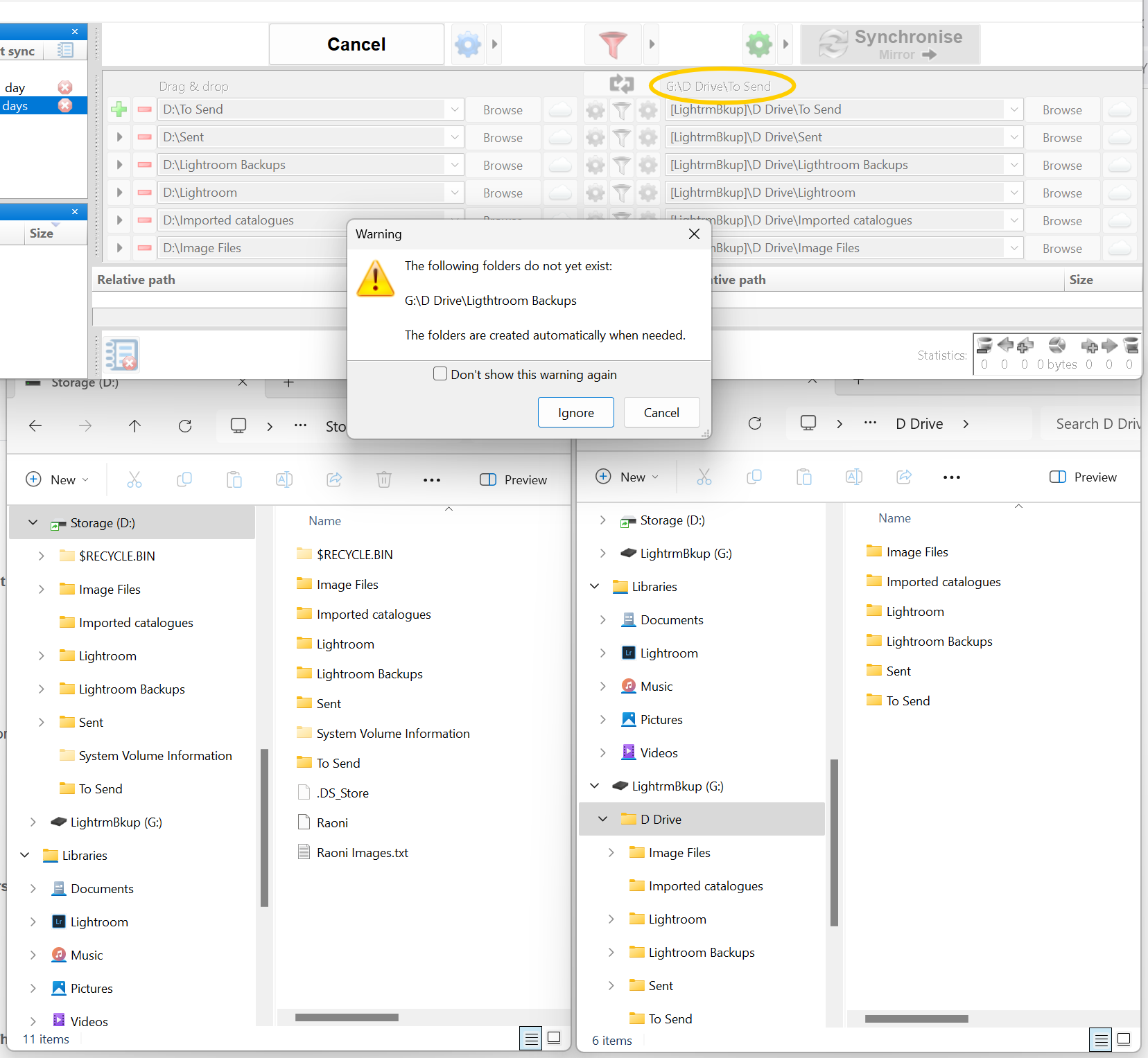

I set up a mirror of most of a second internal HD (D:\) to a removable USB HD which is identified by its name rather than drive letter. I ran the backup successfully and saved it. But when I reopen the backup and attempt a 'Compare' it fails with a 'The following folders do not yet exist' error.
The relevant folders do exist. Here is a screenshot showing the result of the 'Compare', with Explorer windows showing the folders. The target at the top of the FFS window shows 'G:\D Drive\To Send'
Result of Compare.png (265.42 KiB) Viewed 2015 times
If I close FFS and eject the drive, then reopen FFS the target shows as "?:\[LightrmBkup]\D Drive\To Send" which seems to show that FFS understands the relationship between G:\ and [LightrmBkup]. If I then plug in the drive, the target stays "?:\[LightrmBkup]\D Drive\To Send".
What am I doing wrong?

You spelled "Lightroom" wrong in the 3rd row, on the right side

Thanks xCSxXenon - so I did!
But that isn't what was causing the issue. Eventually I found a nugget in the manual:

So rather than fiddling about with the Comparison settings I bit the bullet, re-formatted the drive to NTFS and re-synced the drives. Since there is over 2.6 terabytes of data, this predictably took a day to complete. But it was worth it; all is now well and the mirror compares as expected.

Gotcha, glad you got it working. To be clear, the DST issue had nothing to do with your initial description and picture, which was regarding a warning: 'The following folders do not yet exist'.
