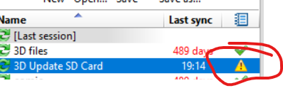

- Joined: 20 May 2024
This is great. I do not consider this a warning or at least I am OK with this. I do not want to program to flag it as a warning. The pop up screen is turned off but there is still a yellow warning flag for that sync after every time it is sync to a SD card. Is there a way for it to NOT to place the yellow warning flag and assume that everything processed without a warning. Thanks for the great product. I am a proud doner subscriber for this wonderful program.
- Posts: 2981
@palmlart
If the warning you get relates to the RecycleBin not being available for your SD card, you can change your Delete and Overwrite setting from RecycleBin to Permanent for that sync.

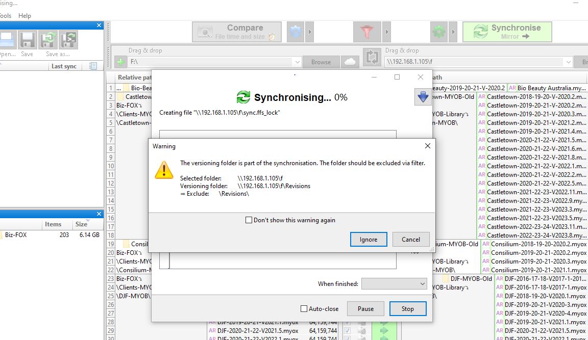

I read all the replies and I do not understand.
I am doing mirroring from PC 1 to PC 2, I am copying the whole of Drive F to Drive F. I tried versioning, making a folder caller 00-Versioning. That threw up errors. I deleted this folder and the recycle bin error came up.
Can you walk me through the configuration steps. I am just an accountant no PC person.

- Posts: 10
- Joined: 17 Oct 2024
Thank you.
No I just did the default and got Recycle Bin not available.
How/what to I do to change to Versioning. What file/folder do I put into the little slit?
- Posts: 4911

Thank you.
I could not get it to work.
- 2024-10-18-Revisions.JPG (147.67 KiB) Viewed 4092 times
- Posts: 4911
Click the red filter icon top-middle, add "\Revisions\" to the exclude box on the bottom
- Posts: 10
Thank you.
So far so good. I will have to wait for it to finish to see if it is OK.
Now I can start another thread on my next problem
