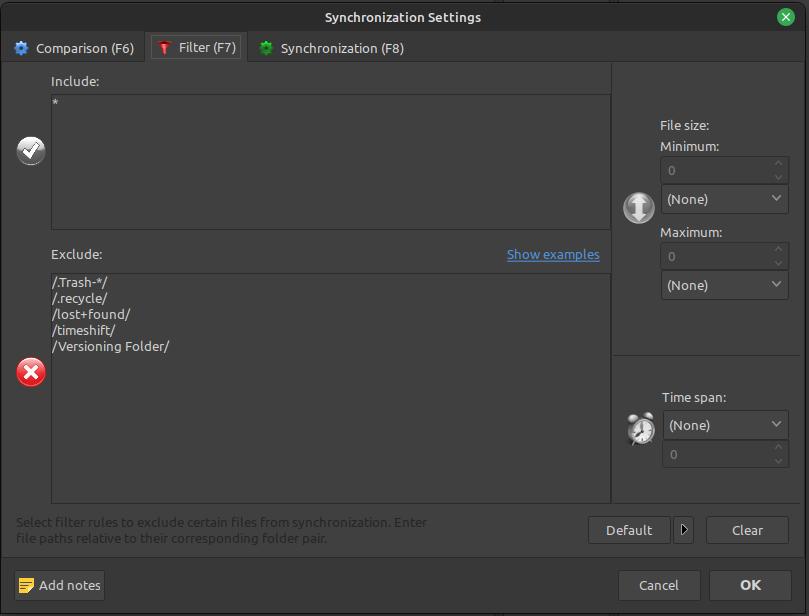

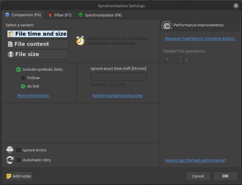

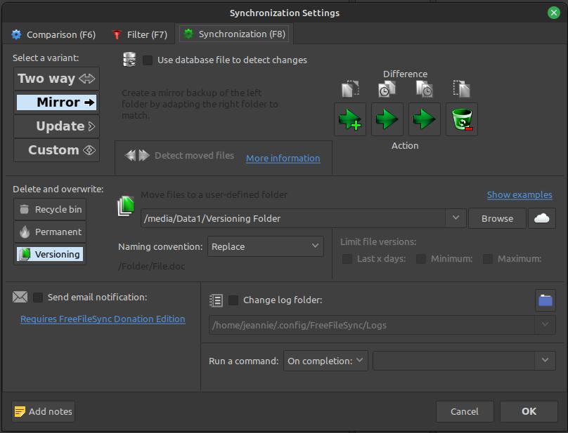

BTW, these are the settings on one of my profiles.
