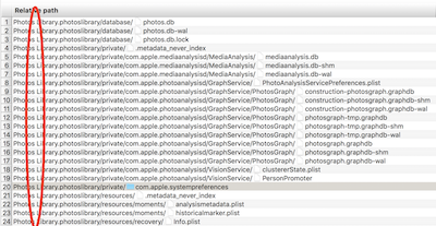

I'm trying to exclude files for backup in my Mac's "/Photos Library.photoslibrary/" directories. Note the space in the spelling. I've entered "/Photos Library.photoslibrary/" in the exclusion list, but FFS ignores the rule, I think because of the space. How do I correct this and get FFS to exclude these files? Thanks.

Thanks, Gianni1962. Right-clicking and excluding that way works just fine. I didn't see I could do that!From User Manual: Exclude Items via Filter
For simple exclusions, just right-click and exclude one item or a list of items directly via the context menu on main dialog.Gianni1962, 05 Mar 2018, 11:33

I try to give you more details.Those directions may make sense to you but that doesn't mean they make sense to everyone. Lady Fitzgerald, 05 Mar 2018, 16:02
Do a Compare so the left and/or right lists get populated, then right-click and include or exclude one item or a list of items directly via the context menu.
Then take a look at the inclusion or exclusion generated and you will see that you do not have to put anything in single quotes or double quotes even when there are blanks in the paths or file names.
