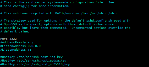

Syncing has been working up until recently when I changed the ssh port to 2222 on the server, naturally I updated the SFTP details to include the new port but it fails to connect.

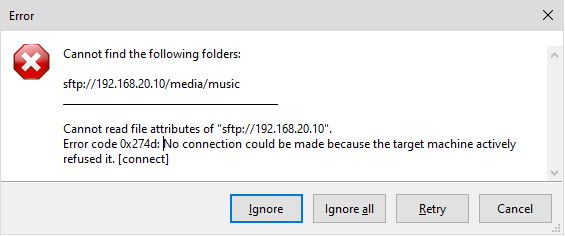

SFTP connection error for any port other than port 22

I just tried from Windows 10 (FFS 10.25) to Raspbian and Ubuntu 18.04 and changing the port to 2222 worked fine for me.
I trust you restarted ssh?

Thanks I did restart ssh, I also tried WinSCP and it worked like a charm no issues whatsoever. At first I thought it was ufw so I disabled it but even with ufw disabled it makes no difference I still get the same error.I just tried from Windows 10 (FFS 10.25) to Raspbian and Ubuntu 18.04 and changing the port to 2222 worked fine for me.

If I try and connect on an incorrect port I receive the following message: Given that your message is different, yet you've disabled the firewall (I'm not running one) and WinSCP is working I'm at a bit of a loss. Hopefully someone more knowledgeable will be able to help.
Given that your message is different, yet you've disabled the firewall (I'm not running one) and WinSCP is working I'm at a bit of a loss. Hopefully someone more knowledgeable will be able to help. simbun, 08 Jul 2020, 14:57
