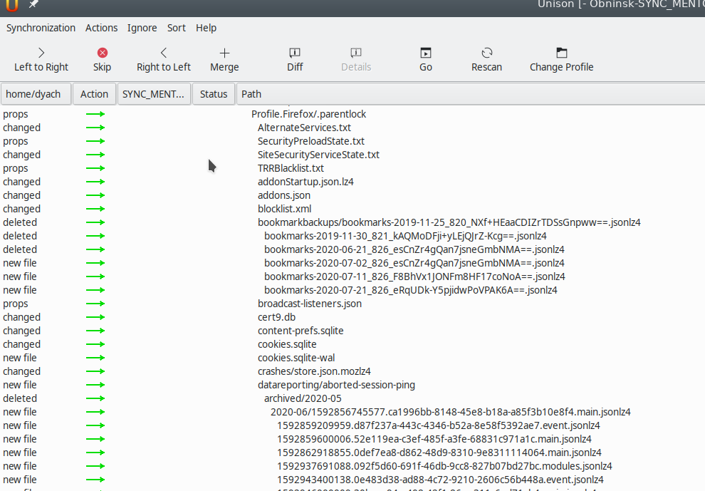

I'm examining FreeFileSync after using Unison file sync (https://www.cis.upenn.edu/~bcpierce/unison/) for many years. Unison is quite a smart application and I never had problems with it, but it's development is actually stalled for many years and it lacks some new features.
It's fully a matter of taste but I find Unison's default compare view a bit more clear for the user because it shows extended paths only for folder or the first file of folder, and all other files in the same folder are just tabbed by several spaces and do not contain paths. So looking at the first entry of the group which is either extended folder path or path of the first file in folder we can easily identify location. And at the same time all other files in the same folder do not contain paths at all (no excessive garbage text), but are marked with tabulation to identify that they are from the same folder. It sound a bit complicated but it's really very convenient. Here is an example Image
When I play with FreeFileSync I find items only mode too short (I cannot easily identify the real path because I see only the folder name) and at the same time I think relative/full path mode is too excessive for files - sometimes their names are truncated because of long paths.
I do not ask you to simulate Unison of course, but I think that allowing separate view settings for folders and files at least for full path/relative path/item name option will make FreeFileSync much more flexible and customizable. For example Unison-like view may be easily setup in FreeFileSync: enable full or relative path for FOLDERS and at the same time item name only for FILES - and that's all.
Possible additional improvements that should be also mentioned (they are directly related):
- Tabulation for files based on their nesting level (1-2 spaces per tab level is quite enough).
- Collapsing or hiding files in folder if they all have the same status. For example, in Unison, if one folder is completely new (on some side) and it contains many new files inside it - Unison just show this folder as one item (marked as new on some side) and do no show all these new files at all - they are hidden because the whole folder is new and the sync action (either auto or manual) is assigned to the whole folder at once. It's just an example of such approach. Hiding may be replaced by collapsing/extending by user request. This prevents text garbage.
But the main proposal is just to separate folder / file settings, make them independent from each other.

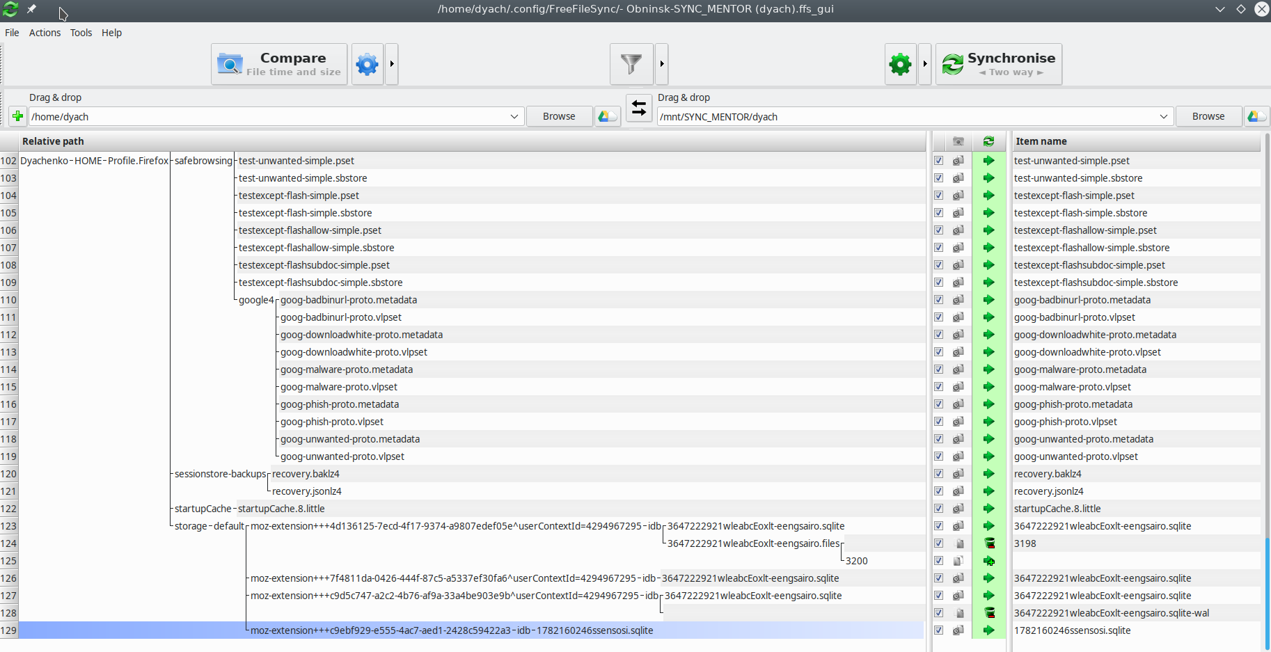

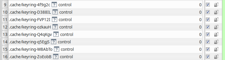

I played a little more and found another related issue. The problem is that if view mode is set to items only (without paths), their related folders (paths) cannot be identified without manually hovering mouse over them.
See the following screenshots:
Both show the same items in 2 different view modes: with or without paths.
Let's assume additionally that path nesting is high (so item names on the first screenshot will be truncated because of long paths) and some of different items a located in the same folder (it's not so on these screenshots but that doesn't matter).
What can we see with additonal assumptions?
The first method (a) will show many truncated names and (b) it is not optimized for many items from the same folder (each item is always listed with it's long path even if this path is absolutely the same as for many previous/next items), it produces mach unwanted textual garbage (repeating long paths for items from the same folder).
The second method show pretty non-truncated filenames without their long paths but it does not allow to identify folders where all these items are located (without manual mouse hovering). The problem here is not only in short name only mode for folders because they use the same mode as files (and it's hard to identify folder only by it's name if it is located deep in folder hierarchy). Additional problem on the second screenshot is that folders are not shown at all! Files with their short names are shown, but folders are completely hidden. For example, in Unison folder path/name is always shown and it is shown only once for each sequence of files from the same folder (and files from this folder are additionally tabbed for convenience) - no textual garbage (repeating long paths that are absolutely the same) and no filename truncation (files from the same folder are shown without any paths, only with tabbing).

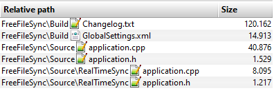

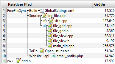

Very interesting ideas, Musenka! The Unison representation has very little redundancy, but is far from perfect. It's hard to make out the hierarchical relation between files and folders visually, and the different indentation for the second and following items of a folder are misleading. But maybe we can fix that.
Here's an example listing from FreeFileSync:
Stripping out the redundant information and adding some grouping gives:
Here's an even cleaner representation:
The "price" of the last optimization is added horizontal space. An alternative price could be adding virtual parent folders instead (even though they might be excluded with the current view filters), but that would cost extra vertical space.
Maybe the clarity alone is worth these costs? Perhaps there is some way to get some additional horizontal space by (partially!) merging left/right representations. However, we need to retain the ability to select left/right items!
Other ideas, improvements?

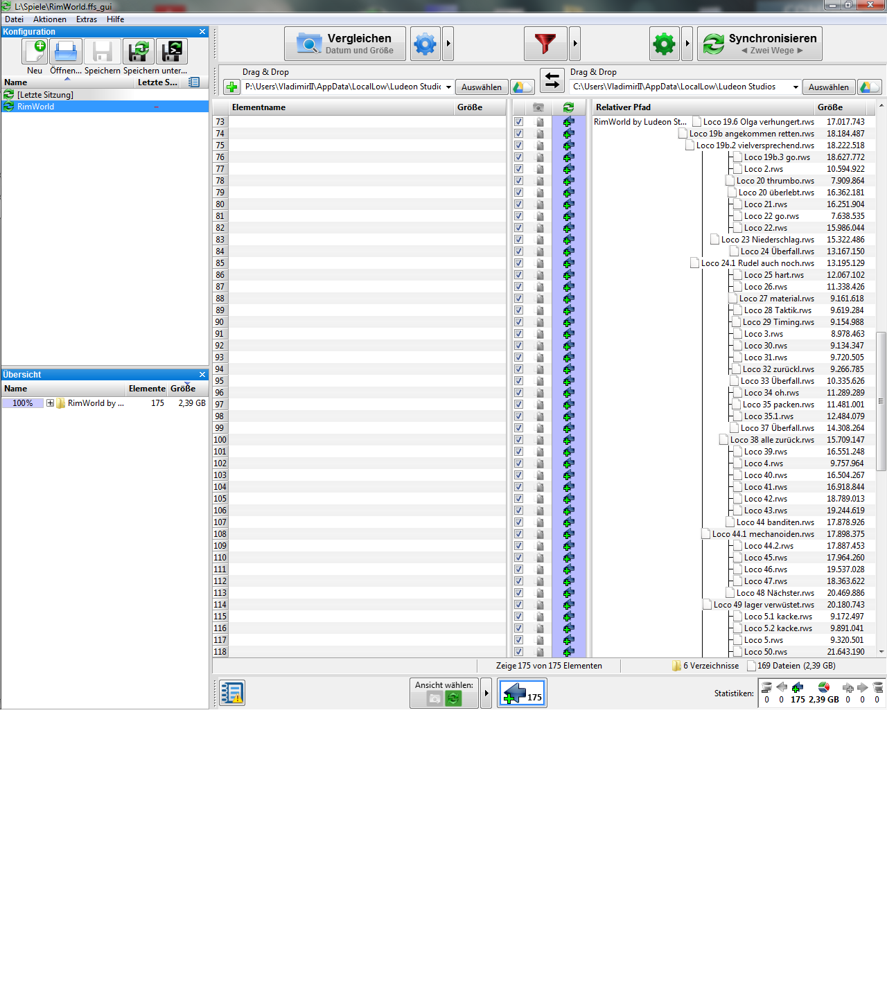

Posts: 33
Joined: 14 Jul 2020
VladimirII
Musenka
For the version before 10.25, did you see you can change the size of the columns? Regardless of the text garbage from path every truncation of file name can be eliminated with that.
What Zenju now did is, just replacing the pathname with white space without reducing the horizontal space needed and introducing an right to left alignment that is mixing at which position/pixel a filename begins.
A total mess now, thanks.
The spaceing 'Unison' does is fine, also the example Plerry posted. But not what Zenju implemented.
Some examples. Mainly from 3.0 to XP
https://www.google.com/search?q=explorer-tree-view&client=firefox-b-d&source=lnms&tbm=isch&sa=X&ved=2ahUKEwizvM2r5dvqAhWBxMQBHT_EDTQQ_AUoAXoECBIQAw&biw=1599&bih=826
Also how is Regedit.exe showing the registry? That´s a nested tree.
I immediadly disagree to your "cleaner representation: " (2.png) suggestion.
For the place to show full filepath also regedit could be the inspiration. There it is in the bottom statusbar. For FFS above the columns would be a possible place. Or the first line is always the full path and no file.
"If you ask me I would prefer saving horizontal space at the cost of vertical space of course." wrote Musenka and all who are rolling back to 10.24 I can say agree with that.
Zenju:"That's essentially the "Overview panel", isn't it?" No, because the overview contains only folders. Perry´s example contains all the folders and files as the regular compare view.
"beta version of my previous design that doesn't save horizontal space" Fine, but the alignment also changed and is not intuitive.
Problem, name truncated, first I do try is adjusting column size. Because in total differnet situations in other software it is the same way to do. Example TaskManager, especially before the new design.
Problem, files are not aligned in a row under each other, reaction: what the fuck is happening?. No immediate idea of solution, start to google. Go crazy or whatever.

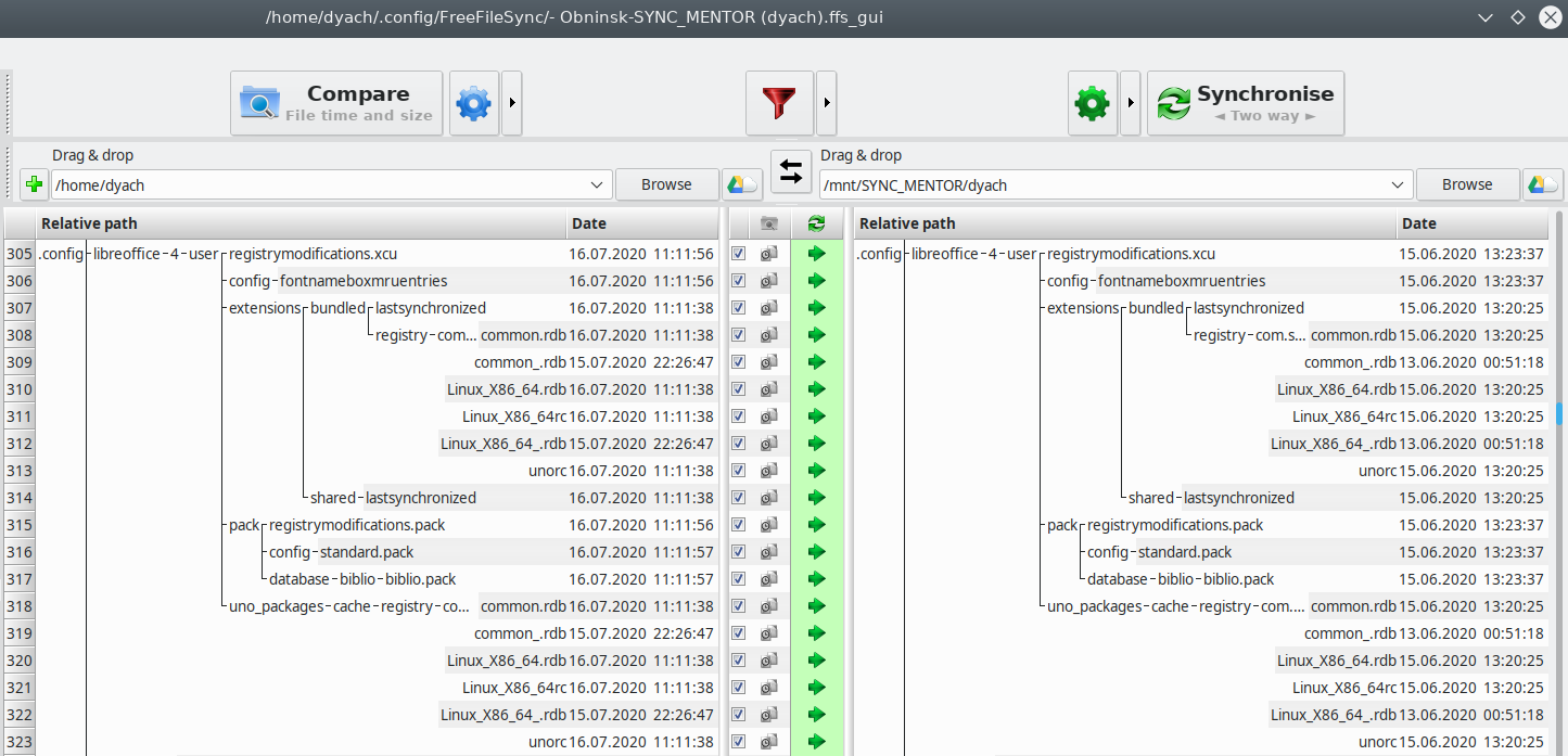

Posts: 25
Joined: 25 Apr 2020
Musenka

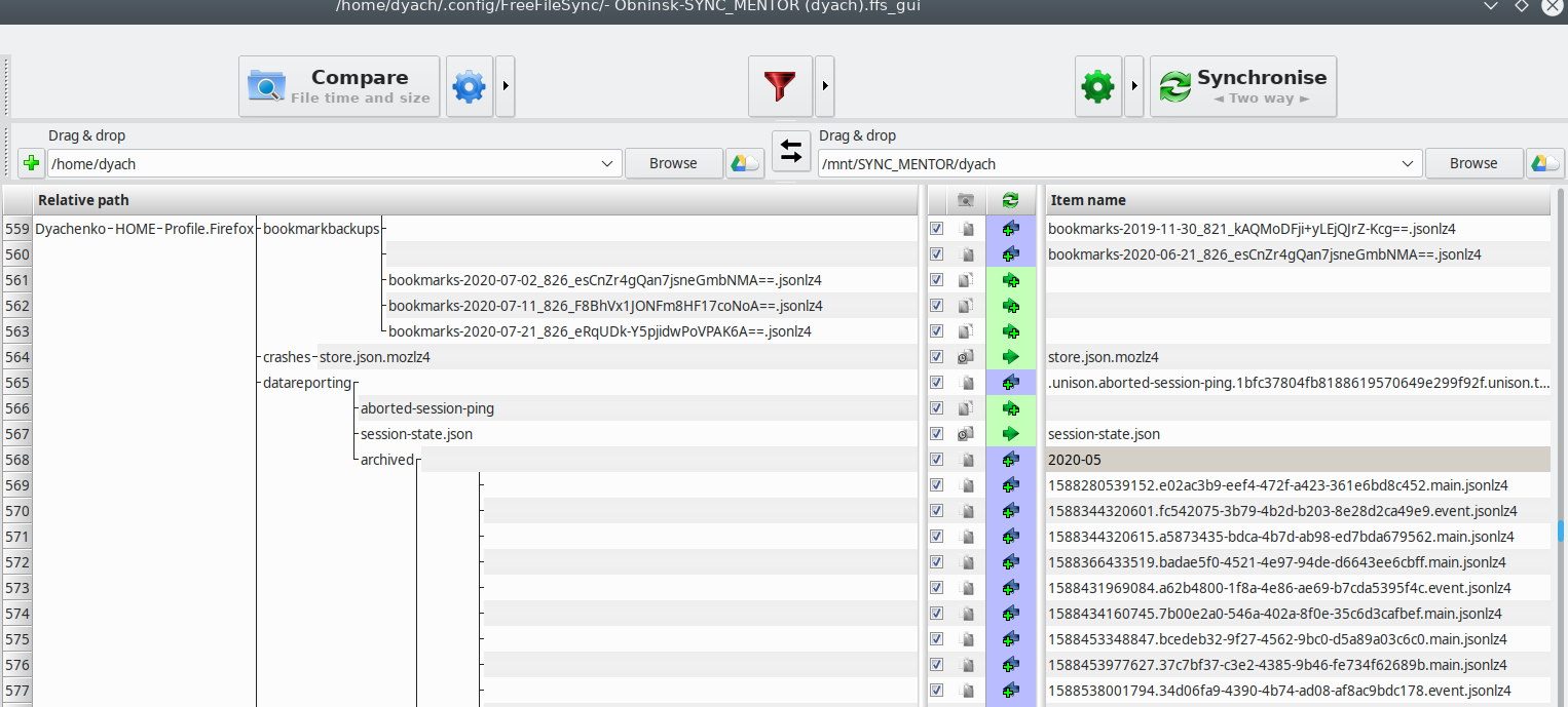

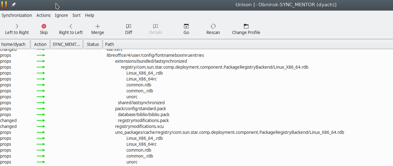

Unison vs FFS 10.25 (linux) Case 1 (various representations):

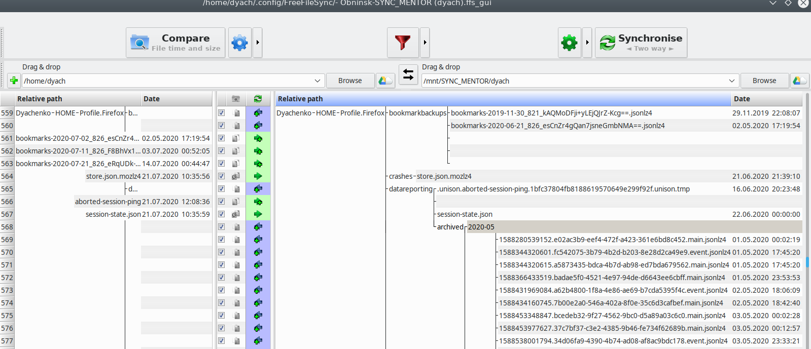

Posts: 25
Joined: 25 Apr 2020
Musenka

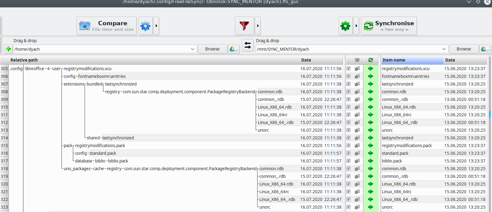

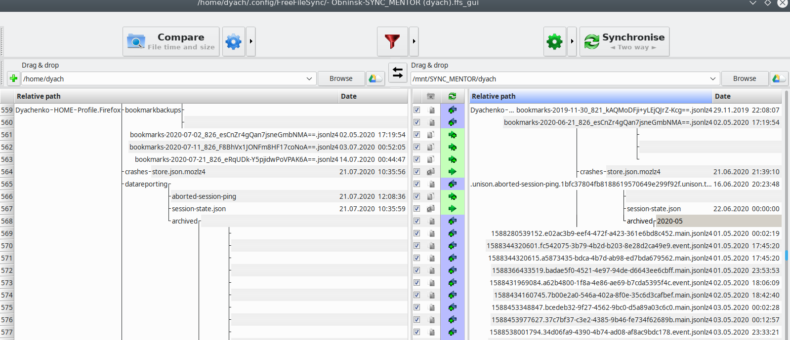

Unison vs FFS 10.25 (linux) Case 2 (various representations):
Posts: 25
Joined: 25 Apr 2020
Musenka
I do not see problems with Column Size and filename alignment. "Prioritize item name rendering if lacking horizontal space" works as expected. Of course, horizontal space is not saved in any way in new layout, but at least textual path-related garbage is removed and filename is showed even for long paths. So I think that there is some representation progress here.
Looking at screenshots set 2 and comparing with Unison I found that it uses quite simple thing to save horizontal space independently from sync direction. In fact it uses relative paths mode and shows relative path ONLY ONCE! The same relative path for left and right locations is named simply as "Path" and it is NOT doubled for left / right "panels" (there are no panels in Unison). Just look at the screenshots.
Posts: 25
Joined: 25 Apr 2020
Musenka
Considering Case 2 when there are BOTH active sync directions: left to right and right to left we see that all representations demonstrated on screenshots become a bit inconvenient. I think when Relative Paths mode is selected for both left and right panels it would be natural and more convenient to see some single universal "Relative path" record which is the same for left and right panels. Or at least there should be no empty folder names for opposite sync directions: using relative path for left and right panels should show the same relative path (not empty!) thus eliminating the need to visualize relative paths twice (for both panels at the same time). So I can use Relative Path mode for any panel (A) and Item name mode for another panel (B) and relative paths will be convenient for both sync directions (no empty records sending us to examine path on another panel as it is now). Sounds complicated but look at all these screenshots and some ideas for improvements arise at once.
In any case, representation seems to be improved IMHO. Possible further improvements:
1. Save horizontal space (discussed before).
2. Elimination of duplicating relative path data on both panels (either by using shared "Path" for both panels as in Unison or by showing all necessary path data without empty lines in Relative Path on any panel, so another panel may be safely switched to Item name mode).

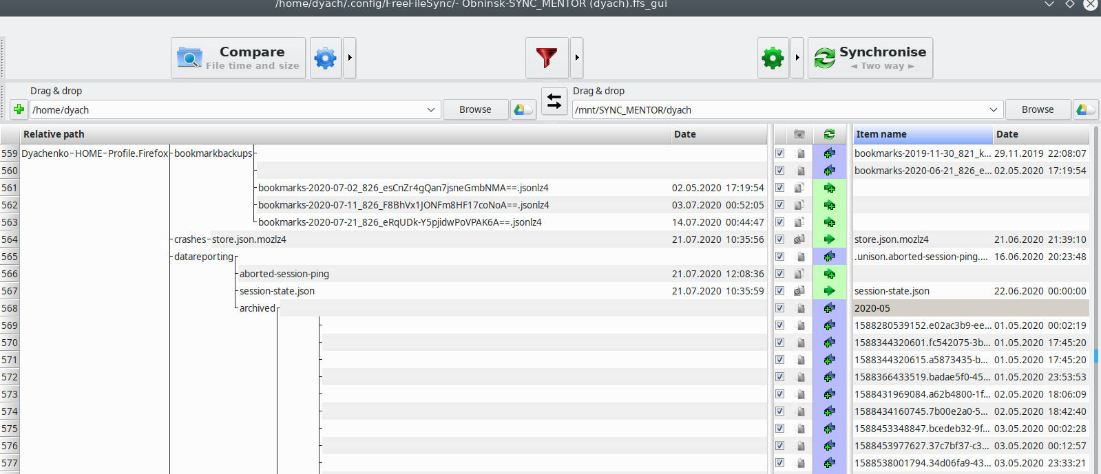

I performed more experiments with real data and would like to thank Zenju for good work on representation issues. In fact when I close Overview and Configuration windows, switch one panel to "Relative Path" mode and another panel to "Item Name" mode and shift panels separation line to the right I obtain very good results.

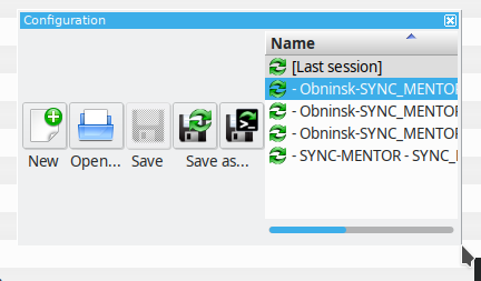

The only thing I cannot understand: why detached Configuration window is not scalable?! It' s so small when it is detached that working with it is a pain (at least on Linux). And detaching is required to save horizontal space and be able to quickly show/hide Configuration window using menu.
Posts: 25
Joined: 25 Apr 2020
Musenka
Screenshots.
The most convenient representation for my data:
Why detached (floating) Configuration Windows is not scalable?
Posts: 7532
switch one panel to "Relative Path" mode and another panel to "Item Name" mode and shift panels separation line to the right I obtain very good results. Musenka, 21 Jul 2020, 12:38
This might even be the best representation for FFS! Parent path information is completely redundant, but item detail info is not (item might exist only on one side, or there may be differences in size, modtime, or file name case).
The only reason why this view is not the FFS default is that it's not symmetric. IOW it just doesn't look good...
Why detached (floating) Configuration Windows is not scalable? Musenka, 21 Jul 2020, 12:48
This seems to be a bug (on Linux). It works on the other platforms. TODO
