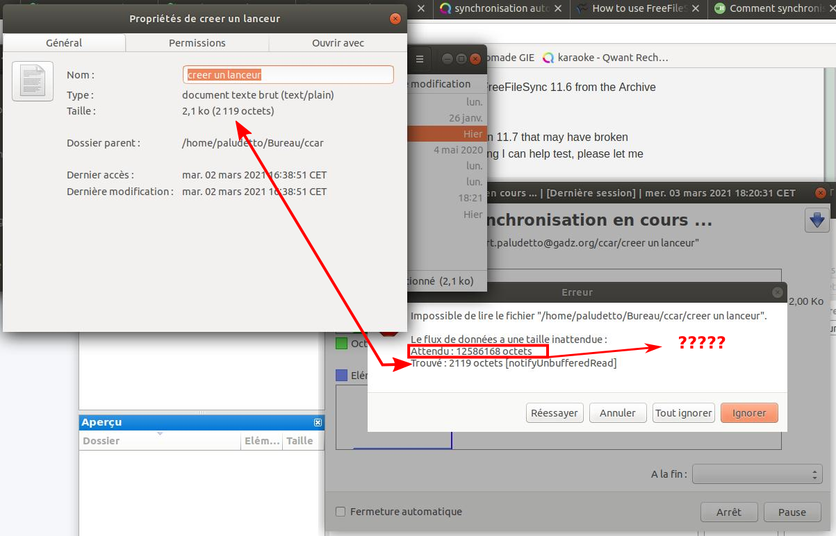

May be the screenshot in attached file will explain the problem better than words...

The screenshots help, found the bug! Unfortunately it breaks file copy from local to (S)FTP, Google Drive completely.
https://www.mediafire.com/file/jib0mffqs84irjh/FreeFileSync_11.8_beta_Linux.tar.gz

Thank you so much too. Tested this morning, it's now ok.
