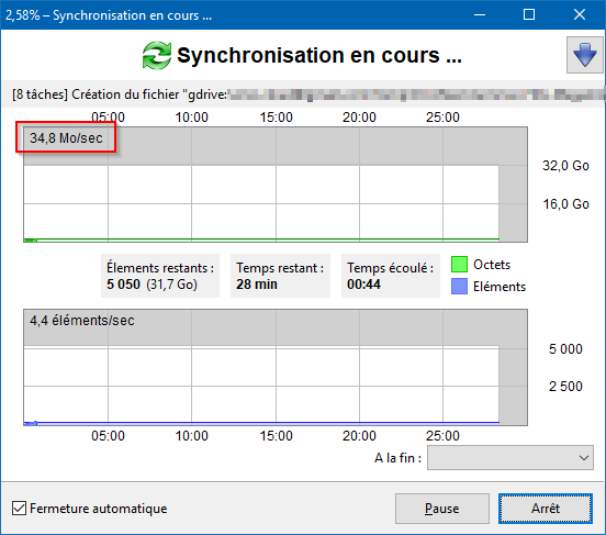

Upload speed with MP3 files (typicall size around 3 MB) is the max of my connection speed (300 Mb/s = 35 MB/s), using my "usual" 8 threads. :)

2019-01-18 14_33_19-2,58% – Synchronisation en cours ....png Illioc, 18 Jan 2019, 13:37

As far as I know, there are these 2 things to consider:I'm not sure how you are getting this kind of speed but my upload to google drive is ranging from 50kB/s to 700KB/s, in other words, extremely slow and extremely below the limitations of both my computer and my network.
1) You should try to make ZIP of any folders you don't use often: you might have seen that performance on small files are always worse than on big files. Especially if you have still use and not SSD. Synchonizing small files is always slow :(. I used "TreeSize Free" (another great free tool) to check the folders having plenty of small files, then I Zip'ped them.
2) There is an option in FFS (added some months ago) that allows parallele processes. Synchronization to Cloud is exactly where it's needed: because it takes some times for the computer to "discuss" with Google Drive and send a file, you better setup 4 / 8 / 16 parallel processes. In my case I've been using 8 processes since the feature exists in FFS: it allowed me to use the max of my network cables and now the max of my internet.
