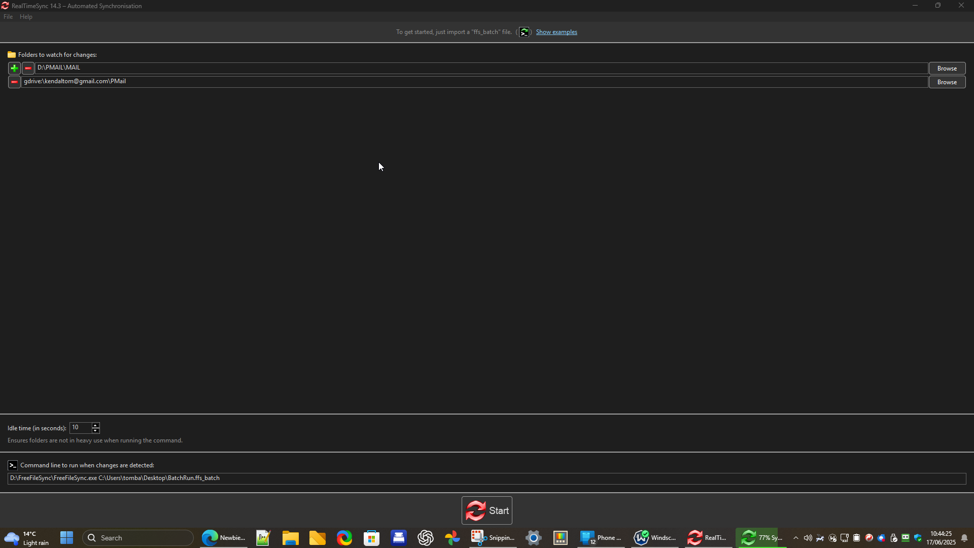

Hi, I'm not too clear on the setting up of this, but think I've got it right (see screenshot). However, nothing seems to happen when I click on Start. It's presumably not a googledrive problem,as it works on manual. What am I doing wrong?

Can't read your screenshot.
But perhaps viewtopic.php?t=12100#p47078 helps
Posts: 4941
Google Drive does not support realtime monitoring, so RTS will not work

Google Drive does not support realtime monitoring, so RTS will not work.
Well, that would explain it, though Goodsync used to do it before they blocked it unless you used the yearly subscription model. Does RTS look at both the source (D Drive) and target (GDrive)?
Try right click, Magnify image

Does RTS look at both the source (D Drive) and target (GDrive)? Tombar, 20 Jun 2025, 07:45
RTS monitors whatever is listed to be monitored. You can have RTS monitor locations that may or may not be present in the FFS sync configuration
I have it set to monitor my mail folder on my D drive, so where does "Google Drive does nor support RTS" come into it?
