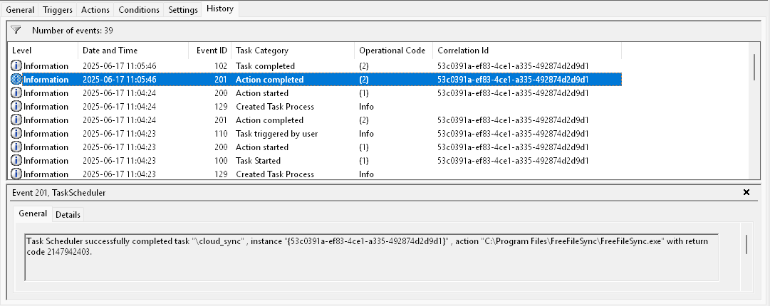

I am experiencing an issue where there is no error dialog shown when running a batch job through Windows Task Scheduler. However, the dialog error is shown if I run the batch job file manually outside of Task Scheduler.
Task Scheduler History returning the following:
"Task Scheduler successfully completed task "\cloud_sync" , instance "{53c0391a-ef83-4ce1-a335-492874d2d9d1}" , action "C:\Program Files\FreeFileSync\FreeFileSync.exe" with return code 2147942403."

Screenshot 2025-06-17 112246.png (49.63 KiB) Viewed 1058 times
