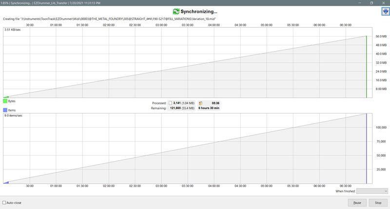

Hi, I was just curious to know if my experience is to be expected.
I have a bunch of Midi (*.mid) files that I'm doing a folder transfer (mirror folder pair) from a SSD to a HDD. The entire content of the folder is only 168MB in size, but there are a total of 147,340 files in this folder with an average size of each file around 200 Bytes each. It seems to be taking forever to complete this transfer. Attached is a screen capture to give you an idea. FFS is showing an estimate of 6.5 hours to complete this transfer. Is this just a Windows thing and to be expected or is this a problem with FFS or something else?

9 items/s is pretty normal for a mechanical hard drive. If you did the same transfer via File Explorer, it would take the same time, most likely. In every previous case of slow transfers, it has always been something externally causing the issue. Try disabling your Antivirus as well. Most of them scan data during the transfer, especially Microsoft Security.

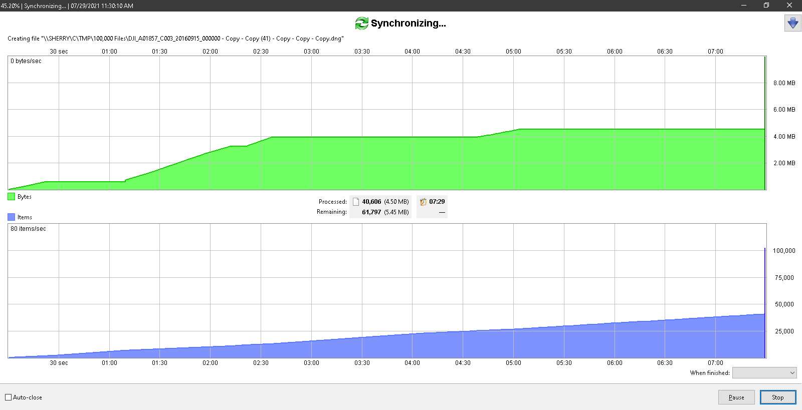

- Posts: 1239
I'd say something is amiss.
43K small items, 18MB.
From SSD to NAS (over 1 GB network).
Win7, no A/V.
(My favorite midi was [I'm pretty sure], baris_manco_gulpembe.mid
https://www.youtube.com/watch?v=HMakfcor4y4).
Win7, no A/V.
- FFS Copy 43K small items from SSD to NAS.png (102.24 KiB) Viewed 8127 times
