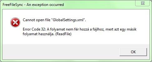

- Joined: 13 Mar 2014
Same error here. We use the installed version, not portable. Everything worked fine until we upgraded to 6.10. We use a scheduled script which call FreeFileSync with parameter(.ffs_batch). Now we get the following error message(see attached screenshot): "Cannot open file "GlobalSettings.xml".
Error Code 32: The process cannot access the file because it is being used by another process. (ReadFile)". We uninstalled it and installed the last "good" version (6.9), but unfortunately the problem is same. I tried to copy the .exe from version 6.2 as John suggested, but it did not help.
I tried to call FreeFileSync_Win32.exe directly from the script, but it did not help.
Anyone has another idea?
- FFSError.jpg (15.88 KiB) Viewed 20924 times
- Posts: 27
- Joined: 11 Dec 2004
Yes, this affects the app in 'installed' mode as well as portable. So, you can't run it from anything else except Explorer or the Windows Start/Tile Menu.
Yes, but it is strange, because sometimes it workes from TaskScheduler, but mostly doesn't. I don't know what is the difference.

Then I grepped on *"Cannot open file"*, lots of references mostly in unimportant language files, some in application.cpp unrelated to our xml file (no mention of getGlobalConfigFile()) one important one in file zen/file_io.cpp in the FileInput function.
Next question, do we get from the application.cpp file to the file_io.cpp file? TL;DR: yes.
Long version: The *runBatchMode* function in application.cpp calls *readConfig(getGlobalConfigFile(), globalCfg, warningMsg)* which is a call to void *xmlAccess::readConfig(const Zstring& filename, xmlAccess::XmlGlobalSettings& cfg, std::wstring& warningMsg)* in process_xml.cpp which calls *void readConfig(const Zstring& filename, XmlType type, ConfigType& cfg, int currentXmlFormatVer, std::wstring& warningMsg)* in the same file with the correct parameters. Sorry for the long function definition copy pastes, but the file contains a lot of fuctions named "readConfig", so better safe than sorry.
Now this template function calls loadXmlDocument(const Zstring& filename) from zen/xml_io.cpp., which on his turn uses the FileInput function mentioned earlier.
So I *think* I found where the error occurs, just not why, or what made build starting from 6.3 break when called from another process. The only thing changed from 6.2 to 6.3 related to these files I just mentioned are in *file.io.cpp*. There are other edits in the code but they are not executed until after the crash I believe. The main thing that changed in file_io.cpp is the addition of Source-Code Annotation Language (_In_ and _In_opt_) at the CreateFile call which aren't interpreted by the compiler anyhow IIRC.
This was my 2 cents, hope this gets fixed soon. I'm willing to test debug versions and offer dumps of all kinds (like I did last time) if I have time :Dbennieboj

Hi Zenju. I've been looking at this bug for a while. It's nothing to do with our packaging. Even when running your standard portable version installed from your installer directly with none of our added bits from the PortableApps.com Menu... which does nothing but run an EXE directly... it produces the mentioned error. The code being executed when a user runs FFS from our menu is only this (replacing the actual strings for the internal variables for readability:so far it seems this problem is only occurring in the context of PortableApps and not when starting normally from Windows Explorer. Most likely it is caused by some conflict with the PA configuration handling on startup that makes applications portable.Zenju
ShellExecute(0,'open', PChar('P:\PortableApps\FFS\FreeFileSync.exe'+#0),Nil, PChar('P:\PortableApps\FFS'+#0), SW_SHOWNORMAL);
The same error occurs for me when run from a locally-installed scheduler utility as well as when run from 3rd party file explorers. Even if you run it from an EXE that just runs FreeFileSync.exe (more on that in a minute).
It's also worth noting that the FreeFileSyncPortable.exe launcher used in our FreeFileSync Portable package was last altered/compiled in October of 2013 and worked perfectly fine up until FreeFileSync 6.3 in March of 2014 when FFS stopped working with 3rd party schedulers, file explorers, etc as well.
I explored the diffs of 6.2 to 6.3, when the issues started, and could not see anything that should be causing the issue.
I have produced an EXE with just a single line of code in NSIS to run FreeFileSync.exe and then wait for it to stop running and it produces the bug as well. You can download my simplified bug reproducer here:
http://portableapps.com/downloads/temp/FreeFileSyncBug.zip
Just place FreeFileSyncBug.exe in the same directory as FreeFileSync.exe and run it.
The bug seems to occur when the Windows process that runs FreeFileSync.exe remains running. If the process exits immediately after running FreeFileSync.exe, the bug does not seem to occur occur. To that end, I also included FreeFileSyncNoBug.exe which will Exec FreeFileSync.exe and then immediately exit. This does not produce the bug on my system. If, however, I add Sleep 10000 after the Exec to keep the exe running for 10 seconds after launching FreeFileSync.exe, the bug occurs.
I've included both EXEs as well as the source code within the above linked zip file. You can compile them yourself using NSIS Unicode Portable (or local, for that matter).
If you need any additional assistance or details, please just let me know.

I can confirm that this is not a "portableapps" issue. I installed freefilesync just today using it's installer and defined as "portable mode." It would not start with double clicking on the main exe file with windows explorer.

I use batch files to run several utilities, including FreeFileSync, from a USB flash drive.
The batch files sit in the root folder of the USB drive. The utilities are in \UTILS\ProgramName folders. Contents of batch file is as follows:
@echo off
cd /d %~dp0
cd \UTILS\FreeFileSync
START /b FreeFileSync.exe
Double clicking on this batch file used to work just fine, but no longer does in recent versions. I get the dreaded Error Code 32 error message. This happens in Windows XP and Windows 7. When I use Windows Explorer or the Free Commander file manager. Or even try to run the batch file from Start | Run.
However, if I open a command window in the root of the flash drive and execute the batch file that way, it works fine.
It would be great if this bug could be fixed. I can still run the program. But it's a real pain to have to launch a DOS box to do so.

Regarding your statement: "The bug seems to occur when the Windows process that runs FreeFileSync.exe remains running. If the process exits immediately after running FreeFileSync.exe, the bug does not seem to occur occur."Hi Zenju. I've been looking at this bug for a while. It's nothing to do with our packaging. Even when running your standard portable version installed from your installer directly with none of our added bits from the PortableApps.com Menu... which does nothing but run an EXE directly... it produces the mentioned error. The code being executed when a user runs FFS from our menu is only this (replacing the actual strings for the internal variables for readability:
If you need any additional assistance or details, please just let me know.critternyc

As a random C programmer: it sounds like FreeFileSync.exe is keeping the file handle open while launching the bin/FreeFileSync_Win32.exe / bin/FreeFileSync_x64.exe. If the launcher manages to quit before the main exe accesses the file, it works, otherwise not.
It sounds a bit wonky that how the launcher is started matters though.. is the file handle getting associated with the process group rather than the process? Either way, closing it in the launcher before firing up the main exe should fix it.
As a test, try directly executing the bin\FreeFileSync_Win32.exe file from your custom exe / menu and see if that works better?

I had tried that when the issue first started without success since the PA.c Launcher can handle automatically selecting the proper one.As a random C programmer: it sounds like FreeFileSync.exe is keeping the file handle open while launching the bin/FreeFileSync_Win32.exe / bin/FreeFileSync_x64.exe. If the launcher manages to quit before the main exe accesses the file, it works, otherwise not.
As a test, try directly executing the bin\FreeFileSync_Win32.exe file from your custom exe / menu and see if that works better?mikeclueby4

this problem occurs when I start FreeFileSync 7 Portable from the file manager FreeCommander.
Unfortunately this can not 100% be reproduced, sometimes it works.
Please fix this nasty bug because I have to open the Windows Explorer for starting FreeFileSync Portable.

version 7.1 still has this nasty bug.
I downloaded 7.1 it and installed it as portable version and I was able to start it from "FreeCommander XE" three times without any problems (start FreeFileSync, close it, wait some seconds and start it again).
But now FreeFileSync shows this error message when I start it.
Sometimes it can be started, sometimes the error is shown.
I made sure that no "FreeFileSync" process is running before I started it.
Zenju, can I somehow help you finding this bug?
