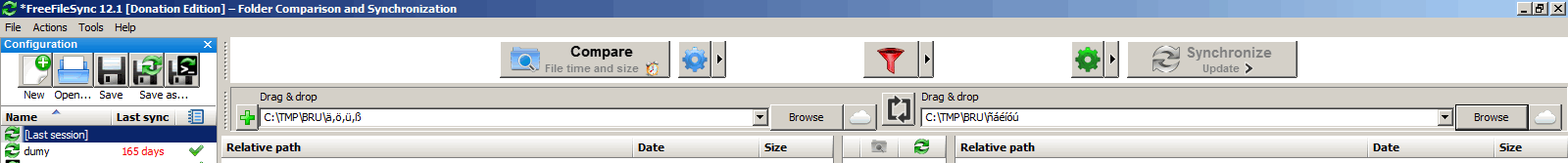

FWIW... 12.1 vs 11.26

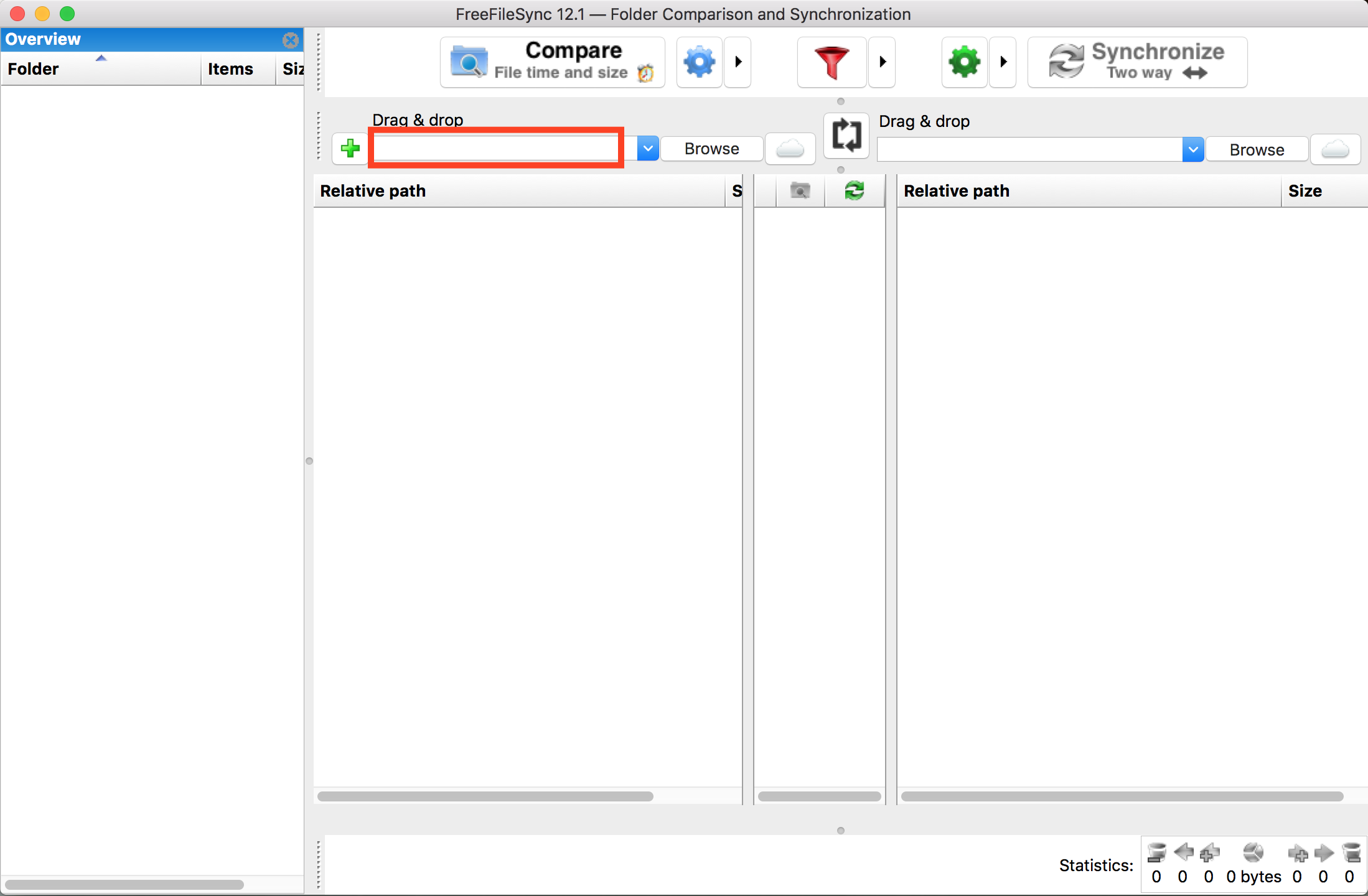

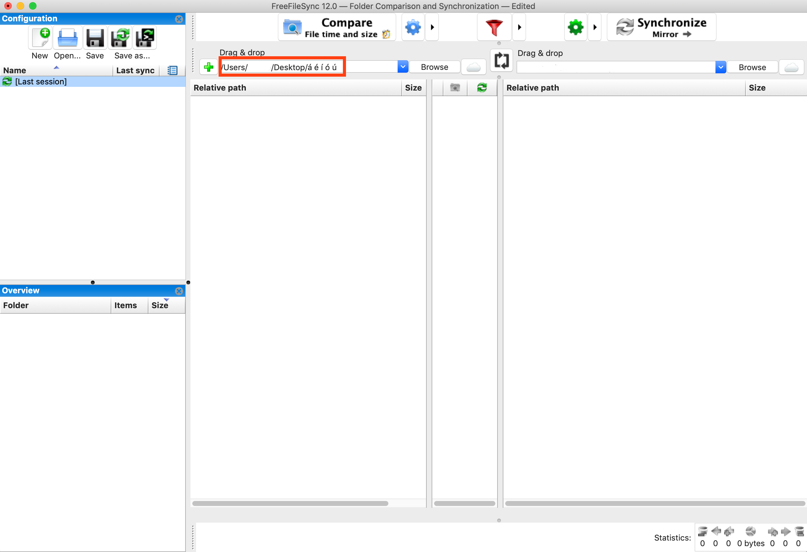

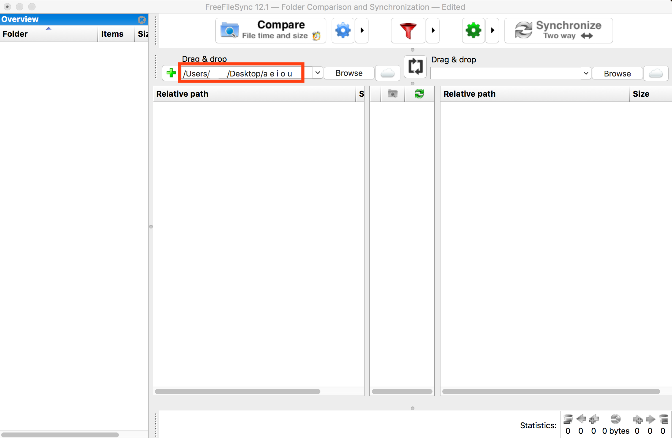

@Zenju. Sure. I created a folder with Spanish characters called á é í ó ú. In FFS 12.0 I can add this folder to the program for comparison (1st image) but in FFS 12.1 I can't just drag the folder to FFS (2nd image). However, if I remove the Spanish characters, FFS 12.1 recognizes the folder (3rd image).

Looks like an issue with drag-and-drop specifically
I'm able to reproduce the issue! Looks like a duplicate of https://freefilesync.org/forum/viewtopic.php?t=8215

Yes, this an issue with drag-and-drop specifically:
FFS 12.0: Drag and drop, the browse option and writing down the path works for folders with and without Spanish characters.
FFS 12.1: The browse option and writing down the path works for folders with and without Spanish characters. Drag and drop works for folders *without* Spanish characters but not for folders *with* Spanish characters.
