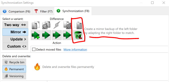

I am synchronizing directories and files older than 90 days. The expectation is not only that I ignore files older than 90 days when I do the comparison but also that files older than 90 days are removed on the receiving side.
In the filter, I have a time span set to 90 days, yet, directories and files older than 90 days are kept from past synchronizations.
How can I fix this?

- Joined: 23 Mar 2023
Thanks @Plerry, your explanation is consistent with my own observations and I was about to implement such a script when I decided to double-check that there was not other built-in way.
I had doubt because of the description for the sync options: I thought that maybe the deletion on the right side was enforced based on the list, after filtering, from the left side. At least, it was my hope.
Thanks for responding anyway.
