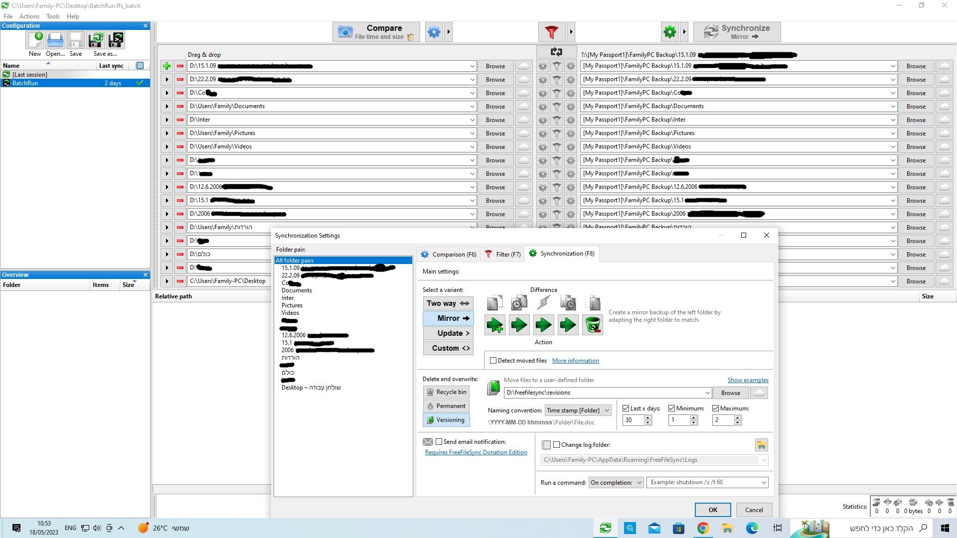

- Posts: 7
- Joined: 17 May 2023
These are my FFS Windows with the versioning settings and locations.https://freefilesync.org/manual.php?topic=versioning
It's not super clear in the examples provided. I am interpreting the documentation in a way that suggests each root location gets a versioning folder in the location you specify, and then everything deleted/overwritten in that location gets put into the root of the versioning folder, regardless of folder depth/location.
I tested this on my own and the subfolder was retained in the versioning folder, so my interpretation is wrong. Considering it works as expected for me, I am wagering that you may have some incorrect settings. can you post a screenshot of your FFS window with the versioning settings and locations visible? xCSxXenon, 17 May 2023, 16:40
- freefilesync_sync_setting.jpg (455.97 KiB) Viewed 1757 times
- Posts: 4934
Looks fine... Can you provide an example of the issue? For my test, I simply made a text file in a subfolder, synced it, changed the text file, synced again. It put the deleted copy in the correct subfolder in the version folder I entered.

- Posts: 7
Here is an example of what I haveThese are my FFS Windows with the versioning settings and locations.https://freefilesync.org/manual.php?topic=versioning
cyoram, 18 May 2023, 08:14
d:/inter/family/example.doc <== I deleted this file
d:/freefilesync/revisions/example.doc <== This is what I get
d:/freefilesync/revisions/2023-05-18 224100 <== This is what I expect to get according to the product documentation when the delete was done at 23-05-18 22:14:00

- Posts: 4934
What you are getting and what you expecting are both wrong...
In your example, deleting 'example.doc' should put a copy here:
"d:/freefilesync/revisions/2023-05-18 224100/family/example.doc"
Is "d:/freefilesync/revisions/example.doc" maybe a remnant from something else? Have you deleted that file from there and then confirmed FFS puts it back if deleted again?

- Posts: 7
I had a typing mistake, here is the right message: Here is an example of what I have
d:/freefilesync/revisions/2023-05-18 224100/example.doc <== This is what I get
<== This is what I expect to get according to the product documentation when the delete was done at 23-05-18 22:41:00
d:/freefilesync/revisions/2023-05-18 224100/inter/family/example.doc
- Posts: 2997
Your expectation is not correct.
When not using local sync settings (the right of the two gear-icons in between each left-right pair), all versions of files in any of the base-directories are written to the root of the versioning location, or when using date-coded directories for versioning, to the root of a date-coded directory in the versioning location.
When you define to use local sync settings for any left-right pair, you can define a versioning location per left-right pair and thereby
if your left base location is
D:\Users\Family\Documents
create e.g.
D:\freefilesync\revisions\Family\Documents\2023-05-18 224100\example.doc
note that you will not get your
D:\freefilesync\revisions\2023-05-18 224100\Family\Documents\example.doc
But for your setup it would mean quite a lot of work, with your many left-right pairs.
Given your setup, a simpler approach would be to define a first left-right pair of
left D:\ and right [MyPassport]\FamilyPC Backup\ for all your D: base folder locations, use local Filter settings for that left-right pair (the funnel-icon in between the left and right base location, and use local Include Filter to define all D-locations that should be included in the sync or, if more convenient, use the Exclude Filter to exclude the few(?) D-locations that do not need to be synced.
And define local sync settings, in which you specify the versioning location (e.g. D_revisions) for D-based files.
And create a second left-right pair for your C-location(s) with local sync settings, in which you specify the versioning location (e.g. C_revisions) for C-based files.
This should give you the desired structure for C-based files, albeit in separate versioning locations.
The only disadvantage of above approach is that this will then sync e.g. the content of
D:\Users\Family\Documents into
[MyPassport]\FamilyPC Backup\Users\Family\Documents
rather than into
[MyPassport]\FamilyPC Backup\Documents
You can overcome this by not including D:\Users\Family (or anything in it) in above first left-right pair, but rather create a separate, third left-right pair for D:\Users\Family with its own local filter settings to define which folders to include (or, conversely, exclude), and local sync settings with yet again its own (e.g. Family_revisions) revision location.
rather than into

- Posts: 7
I base my expectation on help documentation section 2B.
Example: Last versions of the file Folder\File.txt inside folder D:\Revisions
D:\Revisions\2020-12-11 111111\Folder\File.txt
D:\Revisions\2020-12-12 122222\Folder\File.txt
D:\Revisions\2020-12-13 133333\Folder\File.txt
What is the basis for your determination ?
"When not using local sync settings (the right of the two gear-icons in between each left-right pair), all versions of files in any of the base-directories are written to the root of the versioning location, or when using date-coded directories for versioning, to the root of a date-coded directory in the versioning location."
