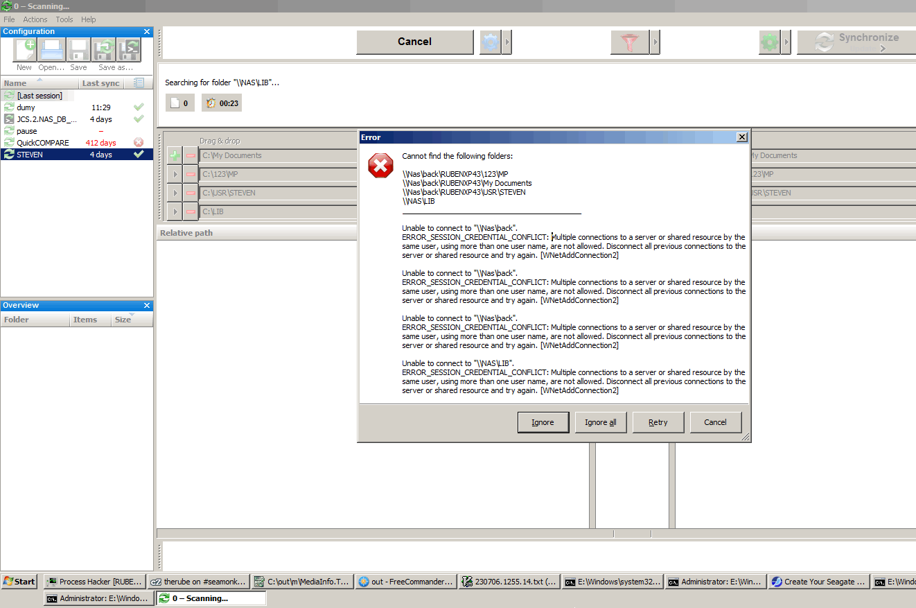

Just pointing out (as I wasn't seeing it noted here)...
Cannot find the following folders:
\\Nas\back\RUBENXP43\123\MP
\\Nas\back\RUBENXP43\My Documents
\\Nas\back\RUBENXP43\USR\STEVEN
\\NAS\LIB
Unable to connect to "\\NAS\LIB".
ERROR_SESSION_CREDENTIAL_CONFLICT: Multiple connections to a server or shared resource by the same user, using more than one user name, are not allowed. Disconnect all previous connections to the server or shared resource and try again. [WNetAddConnection2]
So the NAS has different directories & different logins for said directories, & different user levels for those directories.
There is a \\NAS\Office directory that "they" use, & it it has its' own login, for them (of "office123").
Then there is "me", that has access to other directories, like \\NAS\LIB, & my login can access both "my" directories, like \\NAS\LIB, & also their directories, like \\NAS\Office.
The problem comes in if I happen to login in (to) \\NAS\Office - using their login (so "office123").
What happens with that, is that if I then try to log into "my" directory, \\NAS\LIB, I can't.
I'm greeted (in Windows, in general, & in FFS too) with "Multiple connections to a server or shared resource by the same user...".
