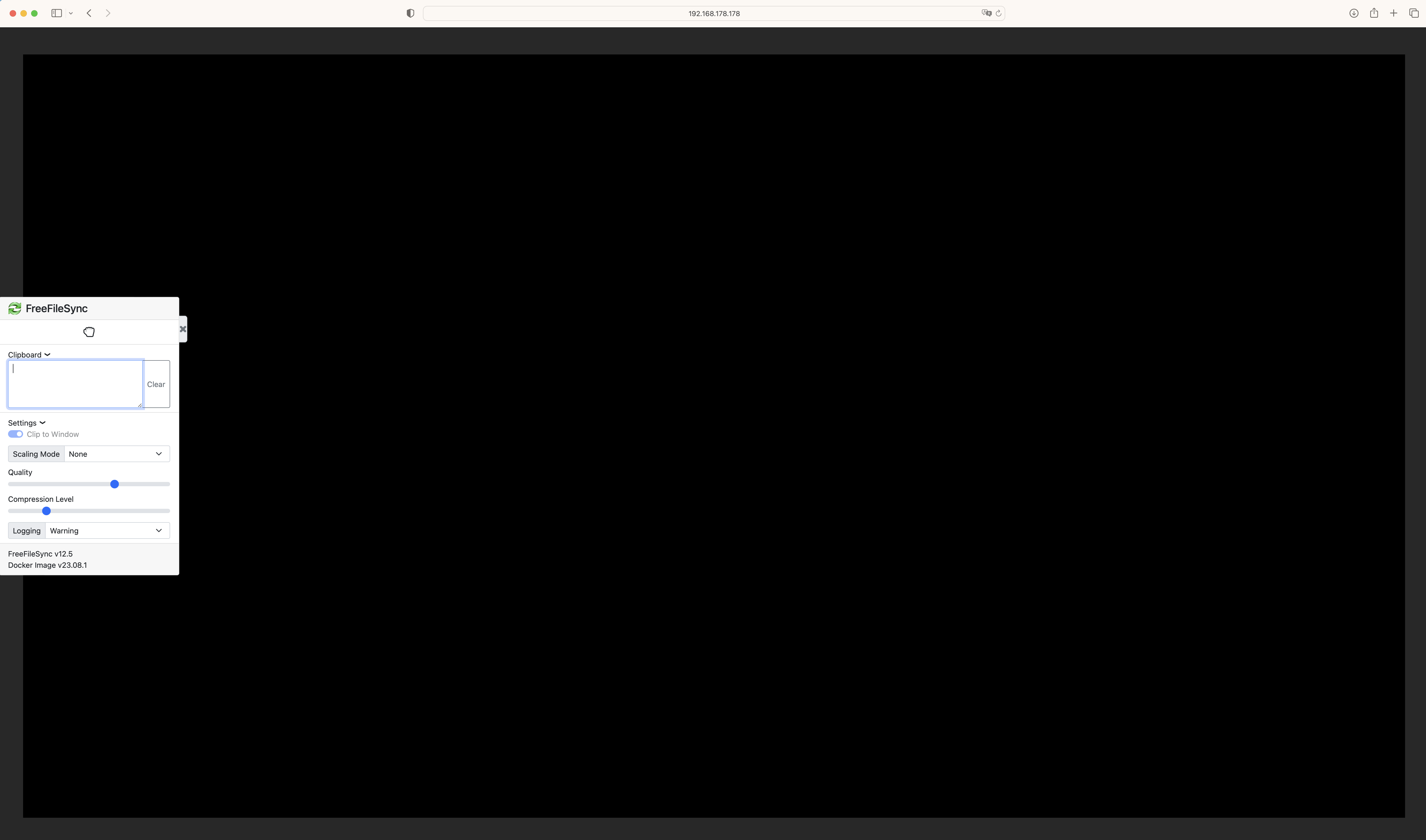

Minimize to notification area broke FreeFileSync [unRAID]
Posts: 3
Joined: 30 Aug 2023
kcnl
I installed FreeFileSync on my unRAID server yesterday and started a disk migration of ±9TB. I'm new to both unRAID and FreeFileSync but saw a blue arrow pointing down saying "minimize to notification area" I thought that was meant for the sync/transfer dialog. Instead -everything- was 'minimized' but I don't know where it went or how to get it back and I'm left with a big black screen.
Since I'm using unRAID I'm using FreeFileSync from the available apps (which I believe downloads a docker) and then runs from within my browser.
Any advice? The transfer is pretty long (40+ hours) and don't want to interrupt that but I can't see the progress either which is kind of annoying.

Posts: 4934
I don't believe FFS has an official version for unRAID, this issue needs to be taken up with whoever ports it to the unRAID app store
Posts: 4934
https://forums.unraid.net/topic/126600-support-kilrahfreefilesync-vnc/
Avoid minimizing the FreeFileSync window as similarly to other containers using this setup there is no way to bring it back. If someone knows a solution ping me in here..
Someone found a solution
As found by @wacko37 below a middle-click will bring up a window list
Right-clicking in the blank space allows opening other instances.
Any further issues need to be sent directly to whoever maintains that package, as the FFS developer does not support unRAID

Thank you @xCSxXenon for your reply, will give it a try when I’m back home and update accordingly.
I wasn’t aware it is not an official port, I’m new to all of this haha.
Any further issues need to be sent directly to whoever maintains that package, as the FFS developer does not support unRAID xCSxXenon, 30 Aug 2023, 14:06
unfortunately this didn't fix :< I'll post in the other forum. Will keep an eye on this thread
