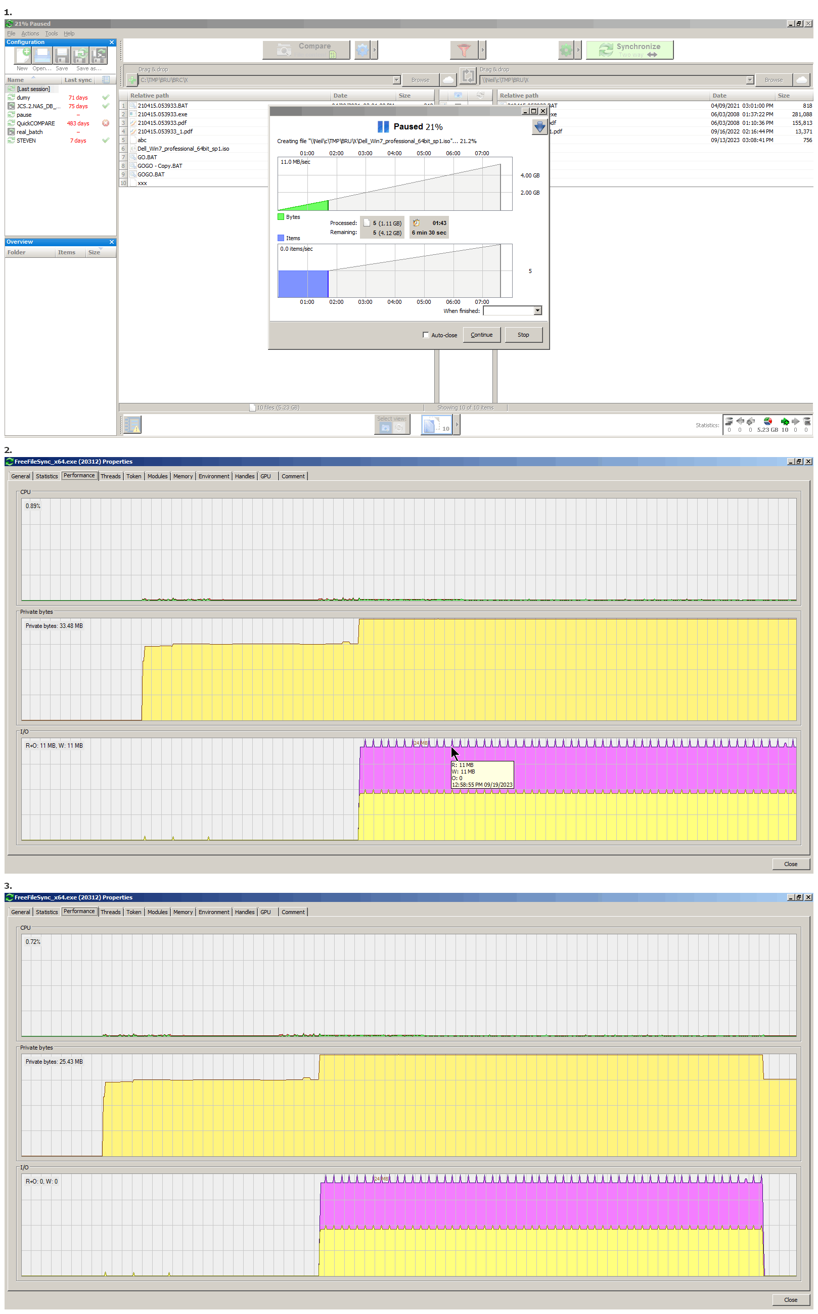

Pausing a sync appears to not stop I/O ?
13.0, Win7
File Content compare
Two Way sync
VerifyCopiedFiles enabled
1. Paused
2. Well after I Pause, but still I/O going on
3. After 'Stop', I/O went to nil

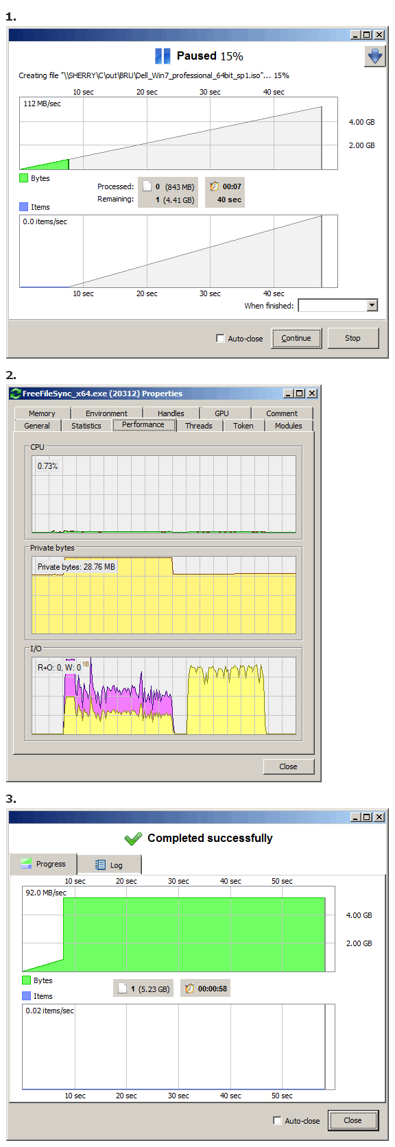

1. here I paused it (almost immediately).
2a. the 1st set of I/O (yellow & purple) shows that the actual I/O continued, & the sync actually finished (even though it was "Paused")
2b. as the sync finished, I/O dropped to 0
(we're still paused during this time)
Then I "un-paused" it.
2c. with that I/O again started (all yellow), & this is the VerifyCopiedFiles kicking in
3. sync had already finished (during the "Pause"), & then, once un-paused, VerifyCopiedFiles also finished.
(& all was done :-))
