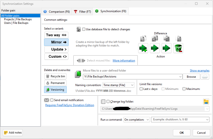

This is how I setup the versioning directory:

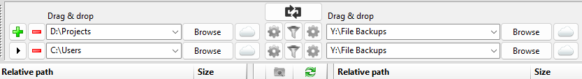

This is what folders are being backed up and to where:

You shouldn't be mirroring multiple locations to one target. What is happening here is Y contains "Revisions", then a sync is mirroring D/C to Y, and since D/C probably don't have a "revisions" folder, that "Revisions" folder is deleted from Y, and then it is versioned to, guess where, "Revisions"!
Now you have Y:\Revisions\Revisions"
Then it that is deleted and versioned, leading to Y:\Revisions\Revisions\Revisions"
On and on and on and on
You need to:
- Mirror D:\Projects to Y:\File Backups\Projects
- Mirror C:\Users to Y:\File Backups\Users\
- Set revisions to go to Y:\File Backups\Revisions
You can of course use different names/locations, but the main things to fix are:
- Mirroring two sources to one destination is bad
- Versioning folder can't be in a mirror destination
