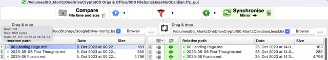

hey hey,
ok i see.
Screenshot 2023-10-25 at 16.33.34 Medium.jpeg (30.68 KiB) Viewed 7691 times
The synced files are acutally more up to date then the original onces. And thus i might always see a difference.
how can i solve this? :/
Posts: 4934
You might need to switch to comparing by file content or file size. Either the use of Google Drive or Cryptomator is likely the cause of the timestamps being lost
