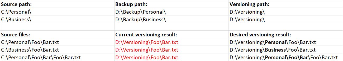

Currently, versioning only creates a copy of a versioned files' parent folder in the versioning root path, ignoring the rest of the file path in the backup folder. This makes it difficult to know where a versioned file was originally located, or to quickly restore versioned files to their original location. In addition, if multiple folders with the same name exist in various locations in the backup folder, the corresponding versioned files will all end up in one folder (shown in red below), even though they have nothing in common.
Example:
Please provide an option to retain the original file path in the versioning folder instead (see "Desired versioning result" above.
Feature request: retain full path when versioning

No, not correct.... Instead of backing up C:\ with include paths, I was using two separate line items. The result should be identical, correct?mahimahi, 24 Nov 2023, 14:33
By using your two left-right folder pairs and Versioning, you loose the Personal and Business separation in your Versioning location.
Example:
If you have a file D:\Backup\Personal\Folder1\File1 that will be deleted or updated by your FFS sync, in your two left-right folder approach that existing File1 will be Versioned as \Folder1\File1 in the root of your Versioning location, and can no longer be recognized as originating form your Personal folder tree. It gets even more confusing if there also exists a D:\Backup\Business\Folder1\ as any files in that folder requiring Versioning will also be versioned to the same \Folder1\ Versioning folder.
When you act as suggested by Zenju, those files will be Versioned into the \Personal\Folder1\ respectively \Business\Folder1\ folders in the root of your Versioning location.
Only for cases with very simple and similar left-right folder pairs (as per mahimahi's case above), it might be possible.I want to second this request. ...kodaxmax, 26 Nov 2023, 03:40
But for more complex left-right folder pair definitions, FFS would need to guess which part of the path in the left-right folder pairs it would need to "duplicate" in the Versioning folder. And guessing undoubtedly can/will results in ultimately undesired behavior.

@Plerry: you are right, thanks for your explanation. I mistakenly seemed to observe that versioning truncated the path immediately below the immediate parent folder of the versioned file (see the third line in my original post). That not being the case, my request is moot.

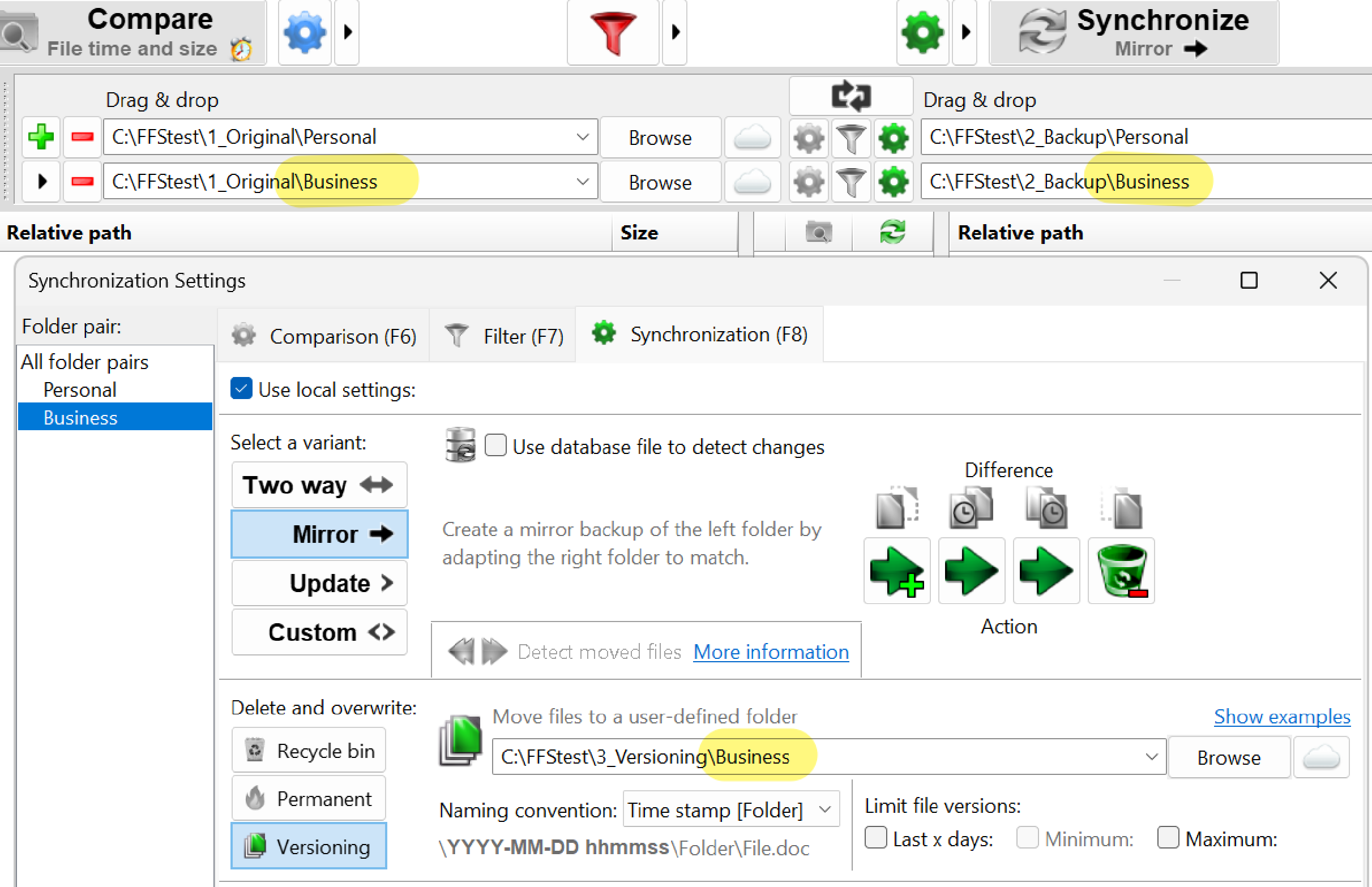

In a case where I do need multiple folder pairs, e.g. to set local file type filters, I simply have to also set versioning accordingly in local synchronization settings for each folder pair.

Obviously, using local (=folder-pair specific) sync settings and then specifying a folder-pair specific Versioning location also solves the problem.
But in general (as also in your example) it is more work.
