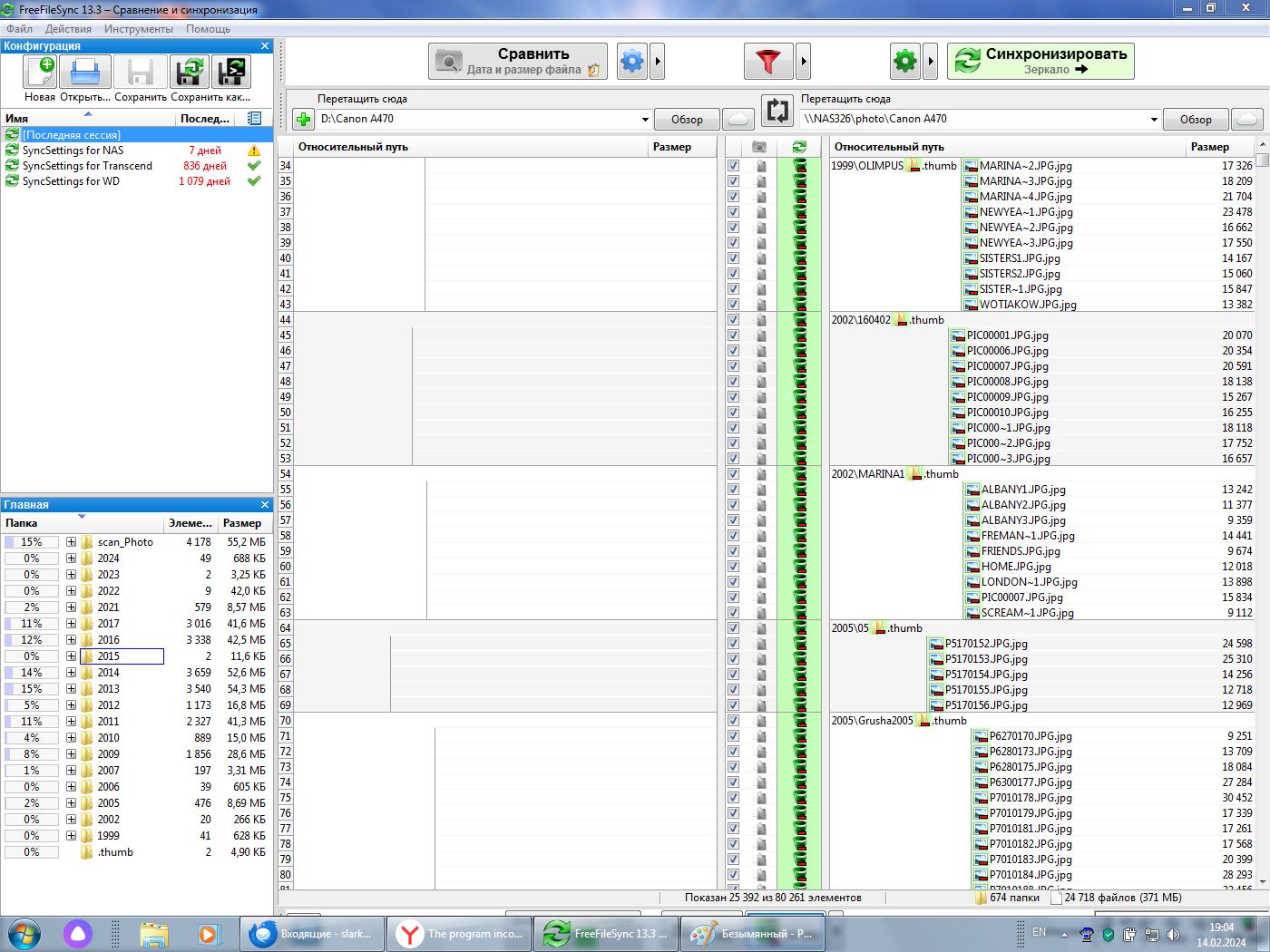

Thank you for participating in my problem. I managed to use the "Browse" button to enter the correct location of the required directory in the network drive. Comparison mode "Date and file size", synchronization mode "Mirror". As a result, all files were synchronized. But when re-syncing to the same directory, the program finds 25392 files again.the thumb that will be deleted. Is this normal?
The NAS is creating those thumbnails and your local computer isn't. This is so viewing the pictures on the NAS in a file browser loads the thumbnails quickly, instead of processing them in real time. Right-click one of the .thumb folders on the right side, choose "exclude via filter:", and choose "*\.thumb\"
Further syncs should ignore these folders and should show the two sides as equal
