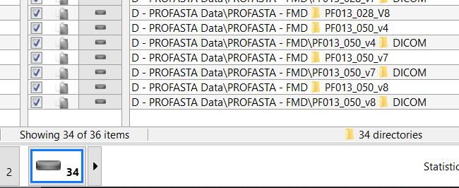

Thanks Plerry. I still don't get it, because I need this particular folder to be treated differently then the rest of the sync. So I need to specify the folder in the rules.
Currently, it picks up the folders, without the files, identifying them as different. The problem though is the action for sync is set to do nothing:
I could manually set to copy them to the left, but that would defeat the automation I seek.
