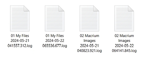

Hey folks, I've got a question about logs. In the general options, I've selected to delete logs after 1 day, but they don't delete (see picture). I've got 2 jobs. In the picture there are two logs for each job; one from yesterday and one from today. As I understand it, the ones from yesterday should've deleted but they didn't. I searched the forum but couldn't find a satisfactory answer to this. Anyone know what gives? I'm using FFS 13.6

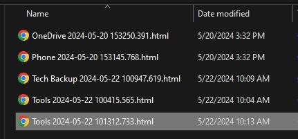

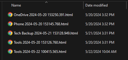

I also have logs set to 1 day. From the testing I just did, it works like this:
- The cleanup only occurs once you run another FFS sync. This makes sense since FFS has to be running to perform this check and cleanup
- For all configurations, FFS keeps the last log no matter how old it is. This makes sense because the 'last status' column likely depends on it
- For the sync configuration you run, it will clean up according to the settings, meaning it will keep the last one that exists
- BUT since you just ran it, it creates a new one. Seems like there will always be two logs for whatever sync is most recently run
This is my log folder before running FFS for the day: This is the folder after running the "Tools" configuration I have: And here it is after running the same configuration again: FFS must be doing the cleanup before running the sync which allows an edge case where the most recent log file is older than the time setting specified and it then becomes not the most recent log

Although looking at your picture, it still seems odd. According to my testing and description, I would expect the "02 Macrium Images" log from 5-21 to have been deleted. It was run first today, so having two logs makes sense. But then you ran the "01 My Files" sync, which would cause that to have two logs, expectedly, but then it also would have deleted the Macrium log from yesterday

I just did a test on "01 My Files" and now there are 3 logs for that job. It's not deleting anything.
