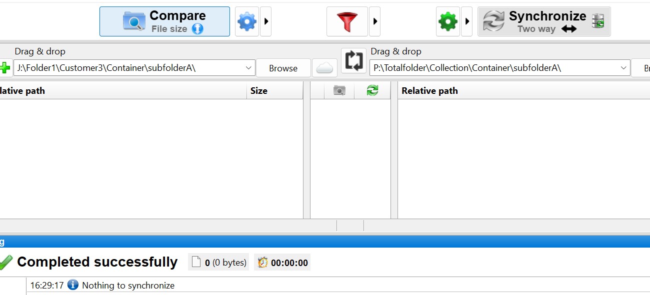

Now I have a screenshot from my example.
When I test to do a 2WaySync you see that nothing have been syncronised, even thou I have 2 new folders, with 6 new files, on J: and 1 new folder, with 2 new files, on P:!
What is it that I make wrong?
Best regards and thank you (and others) for any help!

- Posts: 3019
What your picture shows is that the sync "Completed succesfully".
After a sync has completed successfully, left and right are/should be in sync, and thus the FFS Compare result window is empty.
You can confirm this by performing a new Compare.

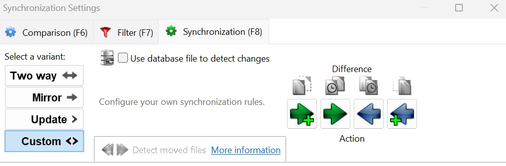

I used file size and file size/date both several times both with and without use of the database setting, and got the same result.
Now I also made a custom sync setting (see picture) but no change in the result = nothing syncs.
I have confirmed by looking in the folders in file explorer.
What do I do wrong?

Yes I have verified with File Explorer that nothing have happened in the folders on both sides.
I have tried with both file size and file size/date with the same result, nothing!
Something I'm doing is wrong, but what?

Hello again!
Mystery solved, I am self to blame for this problem, I am sorry for taking up your time and expertise, but I am very grateful for the help you gave me to try to solve this problem.
What did I do? When I started this 2WaySync that I could not get to work, I totally forget to check The Filter settings. Before I had made a backup sync of my outlook files and used the filter setting to *.ost and *.pst, this setting was still there when I created the new 2WaySync, so when my folders in that sync did not contained any ost- or pst-files nothing did sync.
So I changed the filter settings to *.* and then everything worked as I wanted!
So once again thank you for your help and it is nice to know that this forum works well!
