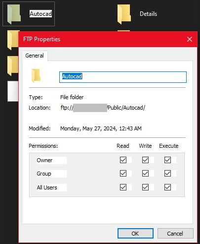

1. Since it was reporting that it could not get the attributes of the file, I thought I would look at those. File Explorer does not seem to show that for FTP sites.

Since your image didn't hotlink, Properties.
Why not simply show directly:

Zenju, thank you for posting the image. I tried to figure that out but the image button only inserts the html code for the link. So I uploaded it to my onedrive just so I had a link. How would I show "directly"? Paste inserted nothing.
