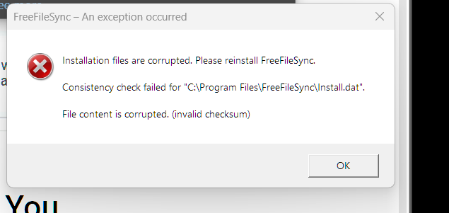

I installed 13.7, and when I try to run, I get the attached message mentioning installation files are corrupted and invalid checksum. I reinstalled 13.6 and everything runs as expected. Any suggestions?
- FreeFileSync13.7 exception occurred.png (20.3 KiB) Viewed 859 times
- Joined: 2 Jul 2024
I resolved the issue by running the installation executable as administrator.

Wonder if something changed in the installer process between 13.6 & 13.7 ?
Or maybe some sort of permissions issue where the old 13.6 install.dat couldn't be replaced by the newer 13.7 install.dat ?
- Posts: 7523
This doesn't make much sense. There is no way to run the installation other than "as administrator" a.k.a. elevated.I resolved the issue by running the installation executable as administrator. luckyfuso, 02 Jul 2024, 18:24
- Posts: 1222
Maybe UAC is turned off & that is somehow affecting things?
What OS (& version at that) are we talking about?
