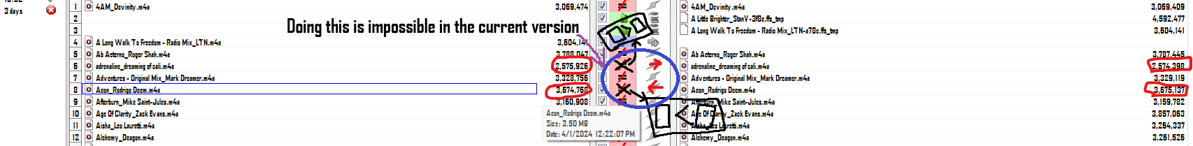

Cannot update items that have the same name but are smaller

Look at the screenshot.

This is correct behavior based on what your picture shows. The sizes are different, so FFS knows there is a mismatch. It looks like the timestamps are the same, so FFS can't know which side to keep and which to destroy, which it why it shows the conflict icon (lightning bolt).
