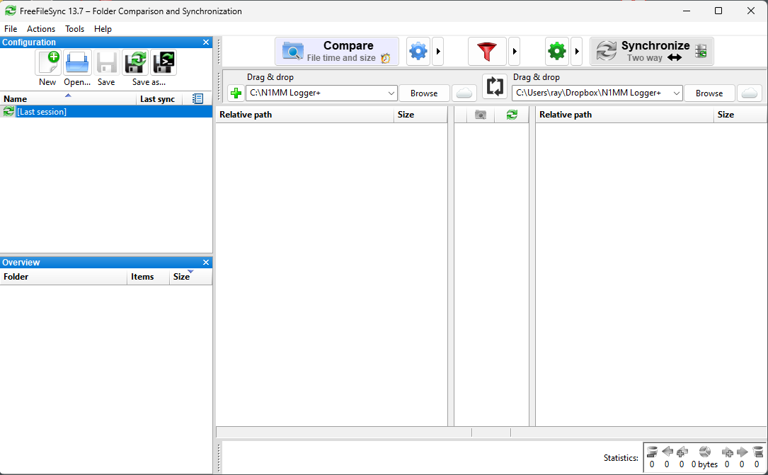

To accomplish this, I set up a directory pair on my desktop computer where one directory is in the root of my C: drive (e.g. - C:\DirectoryName), and the other directory is in my DropBox folder (e.g. - C:\Users\ray\Dropbox\DirectoryName).
Everything works properly.

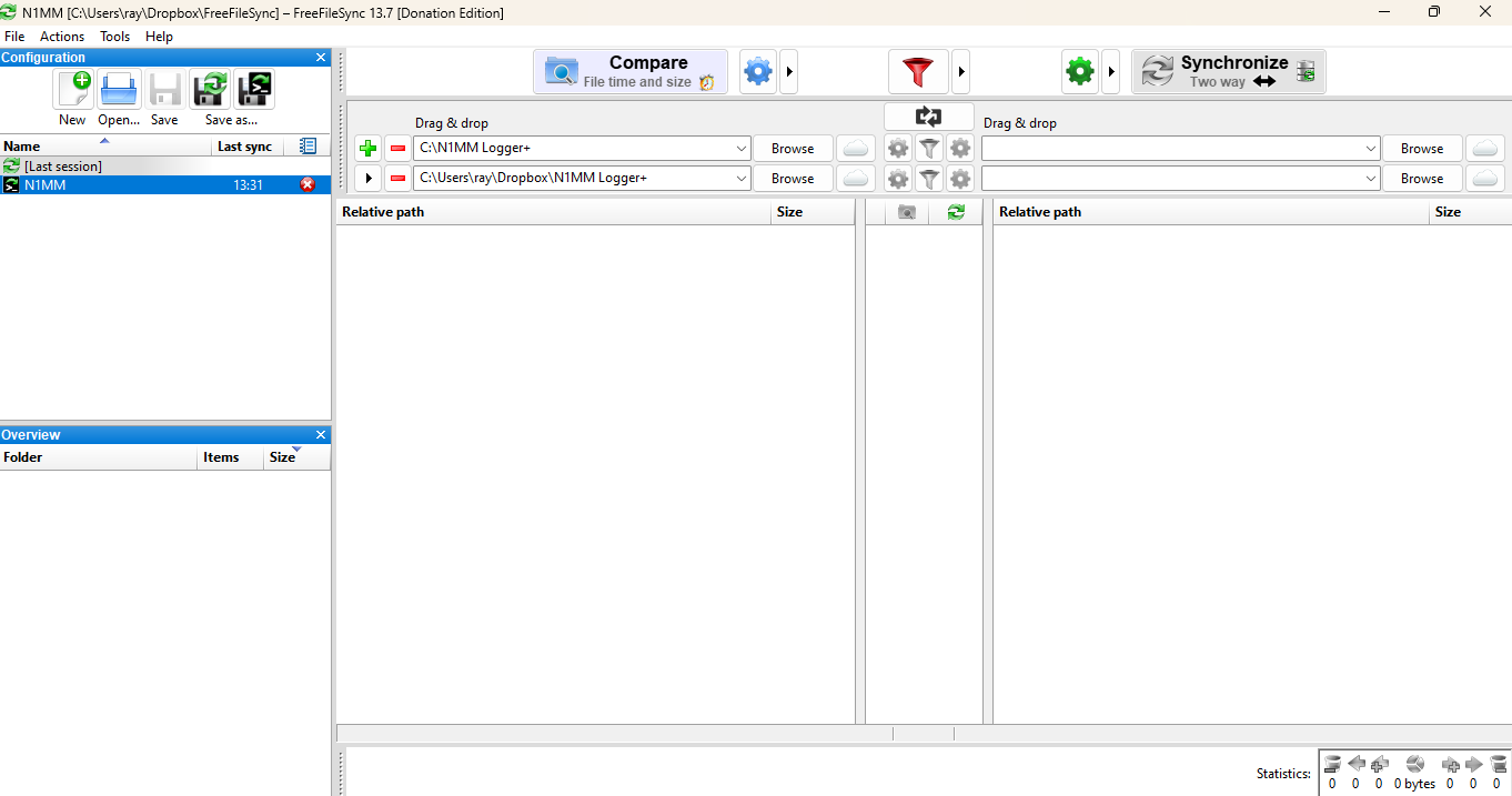

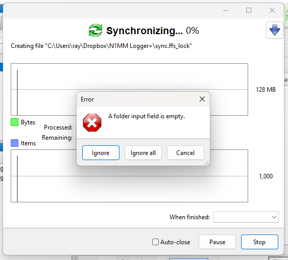

I set up a directory pair on my laptop computer using the same directories. When I try to synchronize, I get the error: "A folder input field is empty."
What does this error mean and how do I fix it?

Yes, both folders actually exist on both computers. I used "DirectoryName" as a pseudonym in my original question. The actual folder name is "N1MM+" as shown in the attached screenshots.
I have attached screenshots of the main FreeFileSync window from both computers & the .ffs_batch files from both computers. I have also attached a screenshot of the error I get on the laptop.

- Posts: 4945
Yep, the laptop is wrong. It is not set up like the desktop is. You see how the desktop has a single line with the local folder on the left and DropBox on the right? Make that the same on the laptop by:
1) Move the DropBox path from the left side on the 2nd row to the right side on the first row
2) Hit the red '-' the the left of the, now empty, 2nd row to remove it from the configuration
