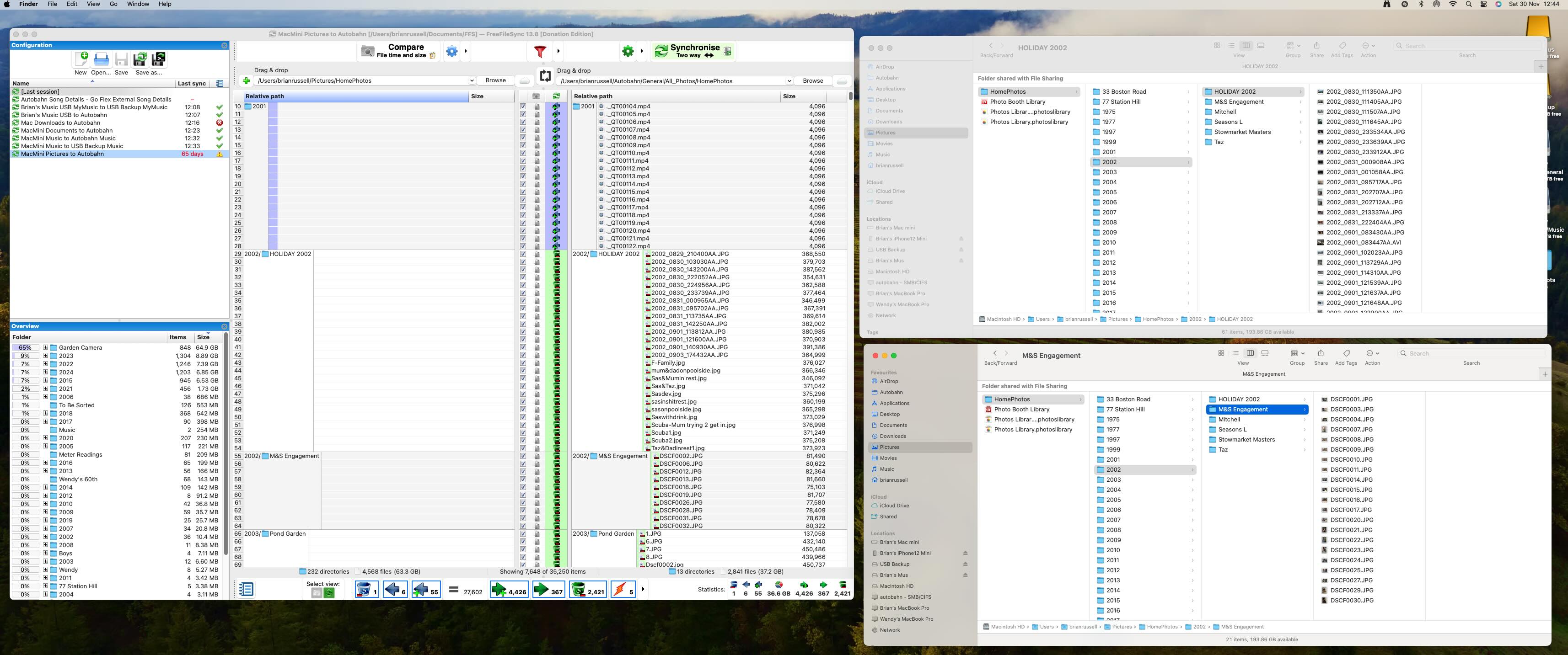

I have just synced most of my files successfully but when I came to sync my Pictures from my Apple Mac Mini Pro (1 yr old) to my Server for some reason the program does not see any files up to 2022. I keep my photos and all my files in directories and subdirectories. When I use finder the files are clearly there. When I use the browse function in FFS the files are mostly greyed out but listed. So the program says it wants to delete by server files as it cannot see the Mac mini files?
I have tried all sorts to try to resolve this but since I have synced the Pictures only about 64 days ago I am lost. I have added loads of Pictures to my Mac mini from my phone but other than this the only change is the latest FFS update.
I am attaching a screenshot where you can see that the FFS wants to delete my server files even though the originals are still available on my Mac mini.

You are syncing to "/Users/brianrussell/Autobahn/General/All_Photos/HomePhotos", which doesn't look like a server path. Is this correct?
- Joined: 30 Nov 2024
Hi. Thanks for the reply
Everything looks correct and i selected it by browsing so not a typo. Not sure about the underscore so will check tommorrow thanks 👍
