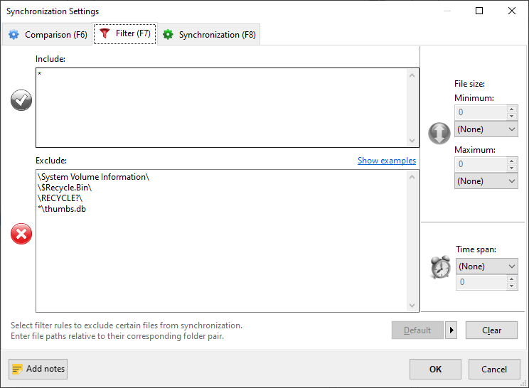

Is "\$Recycle.Bin\" still in your exclude filter?

Here is what I have in the Exclude section for the Filter tab in the Synchronization Settings:
\System Volume Information\
\$Recycle.Bin\
\RECYCLE?\
*\thumbs.db
Also, now that I think of it, I notice this when coping my D:\ to E:\. D: is my main data drive and the E: drives are the backup drives. I don't know if that makes a difference. (I rarely eject my D: drive, but I do copy data from C: to D: using FreeFileSync. I could try ejecting D: after copying data from C: to see if I get the same results, just to test.)
Tim

It almost sounds like FFS is 'stuck' trying to move something to the Recycle Bin. If you change deletions to "permanent", does the behavior change?
