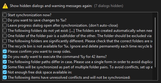

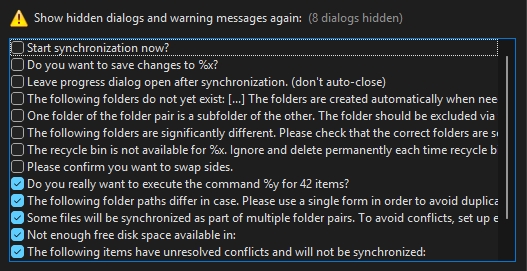

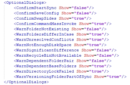

Just encountered this when trying something related to another thread. I have two pictures attached, simply showing the box that I checked/unchecked while testing. Whether the box is ticked or not, clicking the 'swap' button or using the shortcut (CTRL-TAB) does not produce a confirmation box. The "ConfirmSwapSides" line in the GlobalSettings.xml file is set to TRUE.
I have also re-opened FFS between changes and no change in behavior has been observed.
