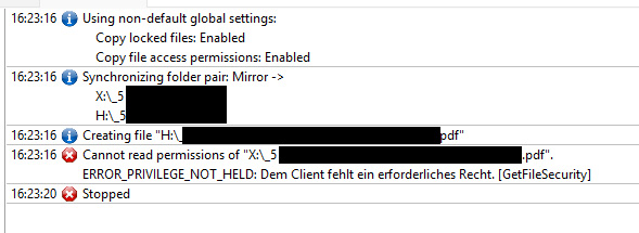

"Cannot read permissions of "X:\_5 xxx.pdf".
ERROR_PRIVILEGE_NOT_HELD: Dem Client fehlt ein erforderliches Recht. [GetFileSecurity]"
See full issue attached. Clicking ignore won't copy the data, all data is affected. Clicking ignore will show the next file with the issue.

I think FFS is trying to copy permissions to the NTFS location, but exFAT doesn't support permissions at all. In the FFS settings, did you enable "Copy DACL, SACL, Owner, Group"?

1) Try disabling in Tools / Options the radio-button [x] Copy DACL, SACL, Owner, Group
