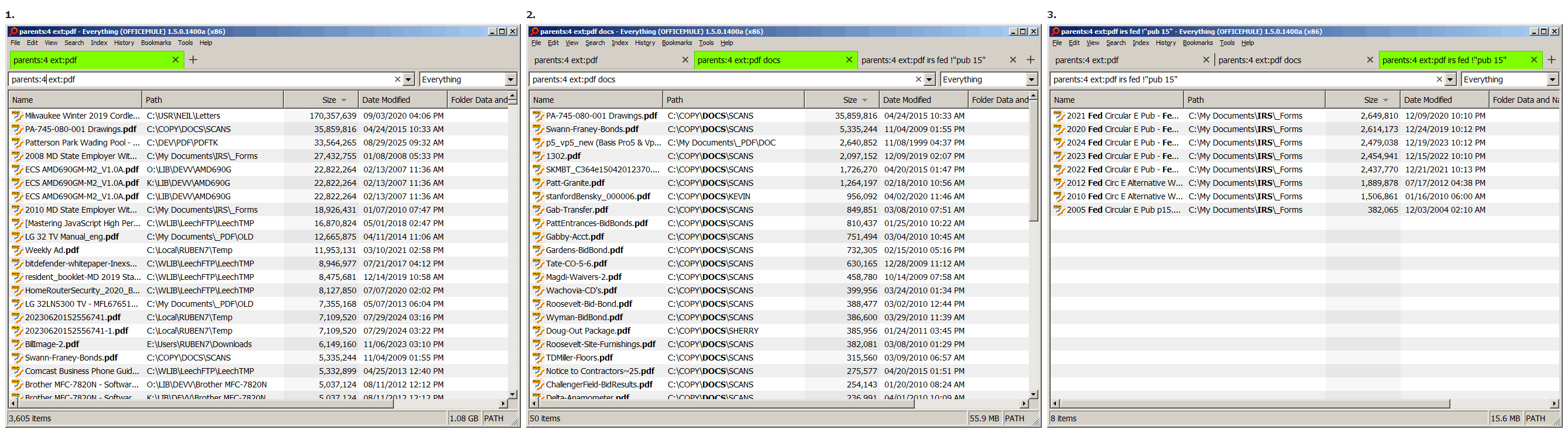

For finding files, there is nothing better then Everything.
Find pdf's in the 4th directory level.
Find pdf's in the 4th directory level & have the string "docs" in a directory or file name.
Find pdf's in the 4th directory level that contain both "irs" & "fed", but not "pub 15".
3rd or 4th directory level, parents:3-4.
Mix & match, sort, filter even more...
Once found, you can simply drag & drop, if that suffices, or export, or SendTo, or...
(Duplicate names or what not, you'd need to account for...)
(Windows. I'm point to 1.5 alpha cause it is so much more powerful compared to 1.4 release, which is still worlds above anything else, https://www.voidtools.com/forum/viewtopic.php?t=9787.)
