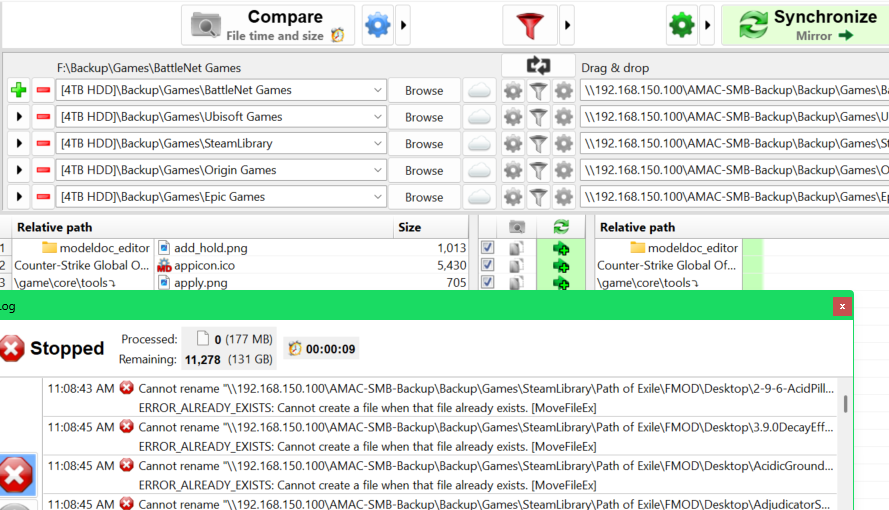

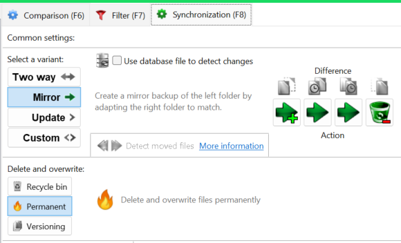

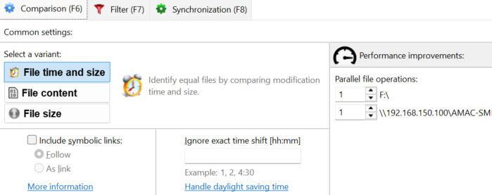

Compare settings is "File time and size" and I've tried other options like "File Content" or "File Size" but it's still the same.

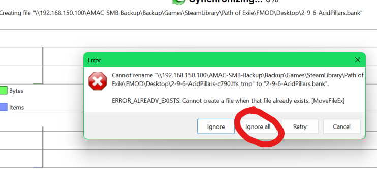

It used to work flawlessly but now this issue happens, quite frustrating as every single time I start the job it has to go through ALL files which takes ages, even though prompting it to ignore all. It used to be lightning fast as it will only sync. changed files.
ERROR_ALREADY_EXISTS: Cannot create a file when that file already exists.
This also happens on my other files like work documents and etc.
FYI this is sync to my NAS (TrueNAS CE latest stable 25.10). Synchronization to my local storage works normally.
