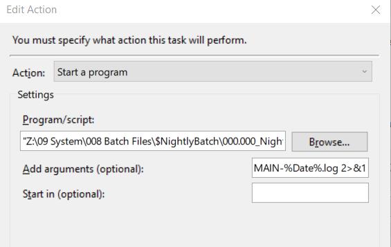

Task Scheduler, in PROPERTIES/ACTIONS/ADD ARGUMENTS specifies "> C:\LogFolder\BatchName-%Date%.log 2>&1" (See attached screen print).

Redirecting STDOUT(1) to "nul" is fine, since potential errors would be written to STDERR(2). But this latter communication channel is rarely used by FFS. Only severe application errors (*not* synchronization errors) would be streamed there.

I'm only vaguely following what you're doing. Sticking only "> nul" at the call to FFS will supress the json info, but leave STDERR(2) alone, which you seem to be capturing by the caller of the batch file. So that should do the trick.
