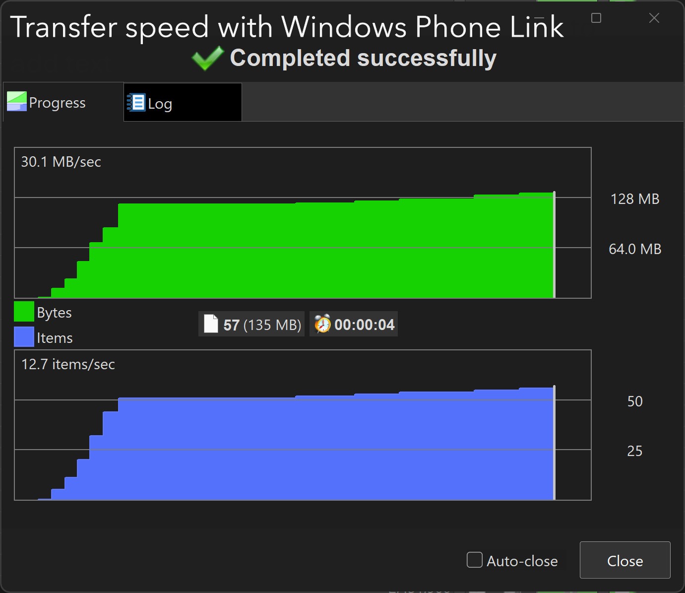

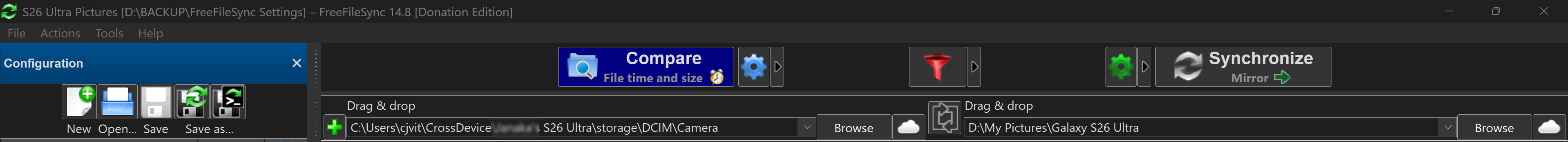

I had the same issue. Syncme Wireless was a great android app that you could use from your android phone to wirelessly sync shared folders between phone and a Windows PC. This is no longer available and I was looking for alternate methods. Apps to set up a FTP server worked. However, now I am using the combination of FreeFileSync and Windows Phone Link to connect and synchronize my Galaxy S26 Ultra. I use it to synchronize photos from phone to PC and files from PC to phone. Hope this helps.

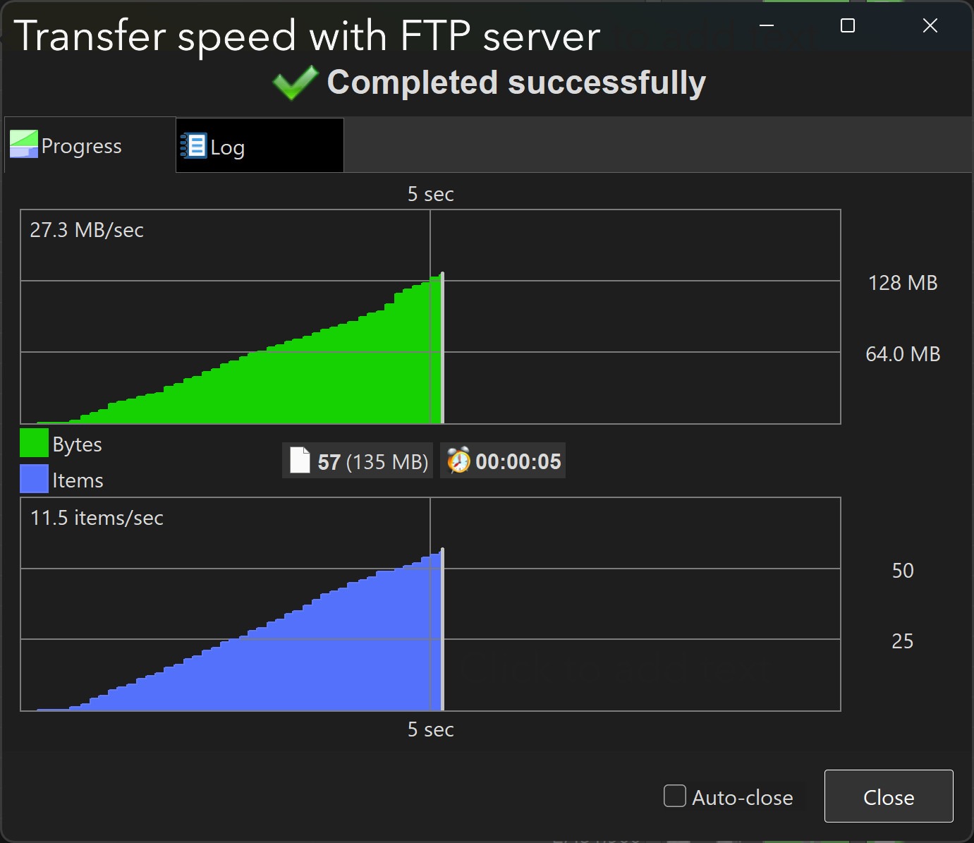

If you do a speed test comparison you should find that wifi ftp is faster than Microsoft phone link.
- Joined: 15 Mar 2026
I didn't find much of a difference in transfer speeds as both are only limited by Wifi bandwith. I just find MS Phone Link and Android Link to Windows a more convenient way to use FFS to sync files. Setting up sync with a FTP server is a little bit more complicated and you have to start the FTP server on your phone whenever you want to sync. Although not a risk if you are on a trusted network the data is encrypted in transit with Link to windows and it's not when you use a standard FTP server.
