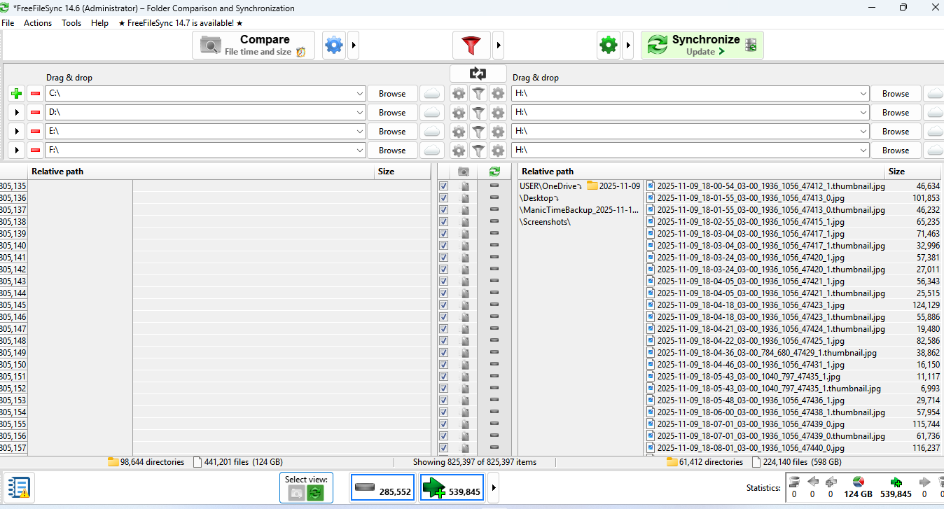

hi, as you can see from the attached image, I cannot find the equal sign that shows duplicate files.
- zenju.png (152.38 KiB) Viewed 248 times

You do not have any pairs containing equal files, then

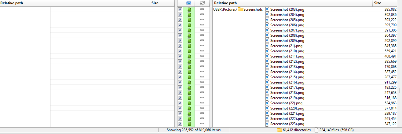

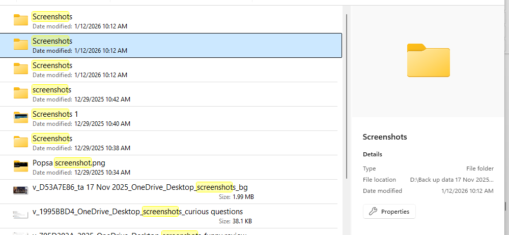

As you can see, there is a folde named "screenshots" in both D and H. so Why is there no equal sign?
- d screenshot folder.png (46.75 KiB) Viewed 230 times
- H Screenshots folder.png (73.07 KiB) Viewed 230 times
- Posts: 2995
You have defined D:\, respectively H:\ as the left and right base location of your second left-right pair.
When Comparing, files are only considered to be equal (indicated via the "="-icon) if files are in the identical path relative to the left, respectively right base location and, depending on your Compare method, their file-time and -size or their file-content is identical.
It seems that, although both D: and H: comprise a subfolder called Screenshots, their relative path to D:\, respectively H:\ is different. Then, FFS does not consider those two Screenshots folders as each others counterpart.
If you make the 539.845 files (with the "=>+"-icon) visible, you will likely see that FFS intends to copy the files in the Screenshots folder on D: to H: in the identical path as on D:
Because you use the Update sync variant (which you have to, because you sync multiple left locations to the same right location) FFS will not delete the files already present in the existing Screenshots folder on H: (the "-"-icon, do nothing), despite there exists no counterpart (with the identical path) on D: .
