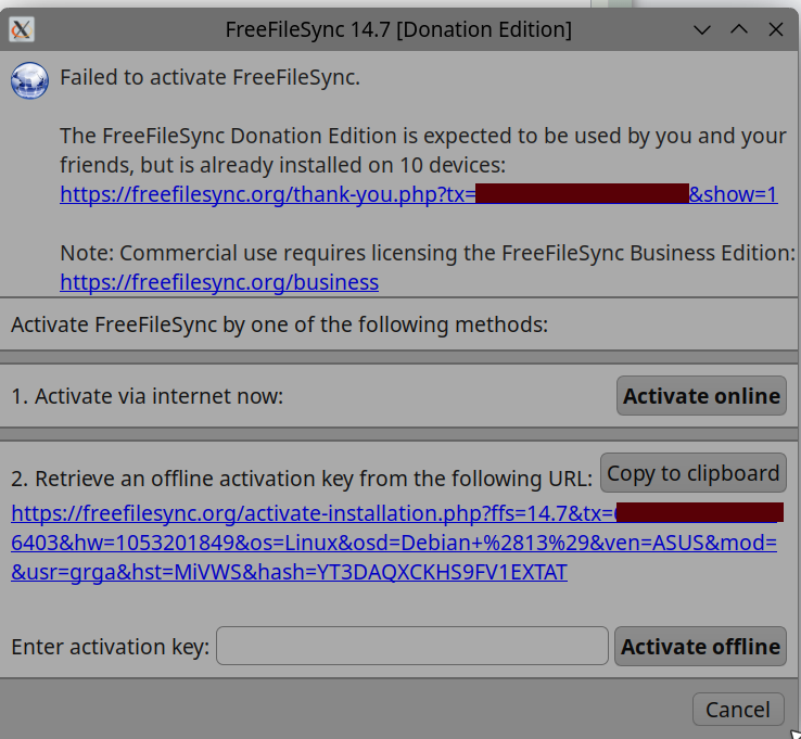

I'm using FFS on my Linux desktop and windows laptop. Since recently everytime i restart a sistem i FFS registers this as a new activation. I started getting warnings and then i was locked out of my Donation edition. If i attempt to remove the erroneous activations it only allows me to do this once a month so no help there.
I would be very grateful for any help because my workflow depends on FFS.

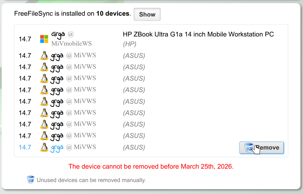

I'm attaching additional screenshots which show the lockout and the fact that 9 of my activations are the same Linux machine:
I'm running Debian 13 on the machine in question, and my workflow is totally dependent on FFS so i would be extremely grateful for any attention to this matter.

For additional context, i'm using a bonded ethernet connection on debian machine so that might be part of the issue. It might be flipping the MAC adress now and then depending on the first network device to come online, but i do not now if that's relevant to the FFS activation at all?
- Posts: 2995
> ... i do not now if that's relevant to the FFS activation at all
Likely not, because, assuming a bond of two ethernet connections, FFS would then at worse register as two different installations on your ASUS (which would still be OK); not as nine different installations .

Ok, I'we found that even though i dont use WiFi, the board has it and network manager randomizes WiFi mac after each sleep or reset.
I can turn that off in a .conf file but i would kindly ask some of the staff to reset my activation count because i'm still locked out.

Zenju has reset my activation count. And apparently redacted a unique licence id i exposed in the screenshot earlier. Thanks Zenju!
On my side i have found that NetworkManager on Debian 13 rotates a MAC adress for the Wi-Fi card, regardless of the fact it's not used. I have disabled that by creating /etc/NetworkManager/conf.d/99-disable-randomization.conf with following content:
I also suspect the bond connection flipping the MAC between the two bonded ethernet adapters, but so far i haven't seen this happen. Will continue to monitor and i hope my experience helps to resolve this. Here is the output of my 'ip link show' to that goal.
While the randomization was on:
After i turned it off:
(the difference is in link/ether entry for the adapter #4 which was randomly rotated)

- Posts: 7532
This! Thanks to your before/after posts of "ip link show" the problem becomes clear:Thanks for the awesome follow-up and explanation, Grga! I wish everybody who gets a solution in a forum would share it, with explanation, like that. bgstack15, 11 Mar 2026, 14:33
eno1 and eno2 are bonded, thous return a locally-administered mac, just like the WLAN interface wlp8s0! The WLAN is then preferred, but the universal mac of either of these devices should have been used instead.
Fixed for the next release! You may then enable randomization again.
