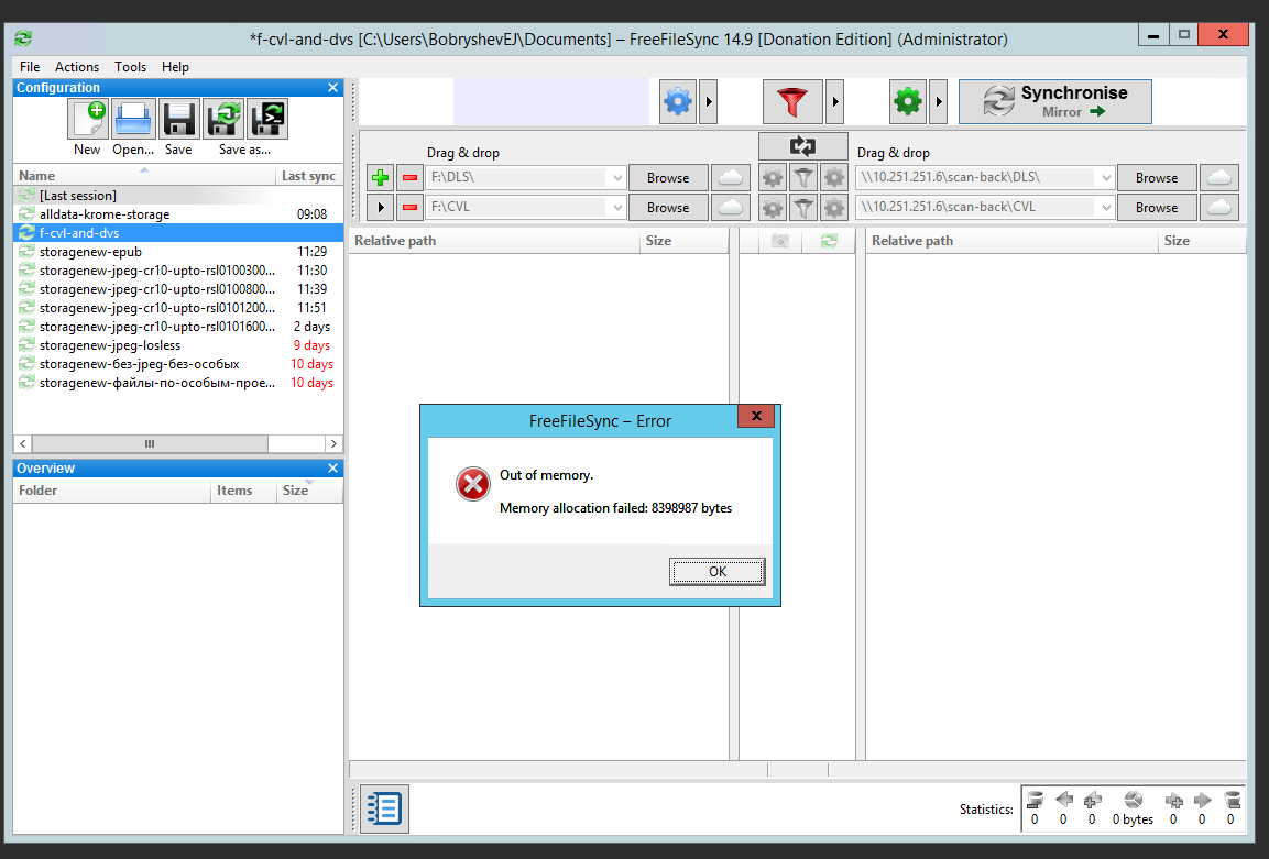

FFS show "Memory allocation failed: 18897667 bytes" during compare phase when machine has more than 40GB of free memory.
OS is Windows Server 2012R2.
Folder I'm trying to sync has 1M+ files, but there are other folders with same amount of files that I've synced successfully before.
Any ideas?

Any error code or message when you get this failure?
- Joined: 15 Apr 2026
It's just "Out of memory" (see screenshot attached)
Task Manager shows 40+ GB of free memory at the moment, and all the way during folder comaprsion attempt.
