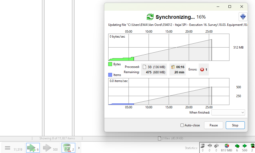

With the Mirror option, I disable the "Update" to the right option, however when starting Syncronization, all the files are still being treated. It seems the program ignores the disabling option (see attached screenshot)
6 files for copying; 500 updating (disabled); delete 2
Effectively, right below, the 500 are still being treated (see the progress graph also)
how to resolve this ??
thank you!!
Syncronizing with Mirror | disabling "update" option to the right not working

I think you only disabled 'update' in the view for the comparison list (in the bottom left corner).
You can disable 'update' in the Synchronization settings (F8). 'Mirror' will then change in 'Custom' sync mode.

Hi, good day and thank you for your reply.
yes, indeed, it was just the view... thanks for this, the custom mode did it.
SMH for not seeing this.
