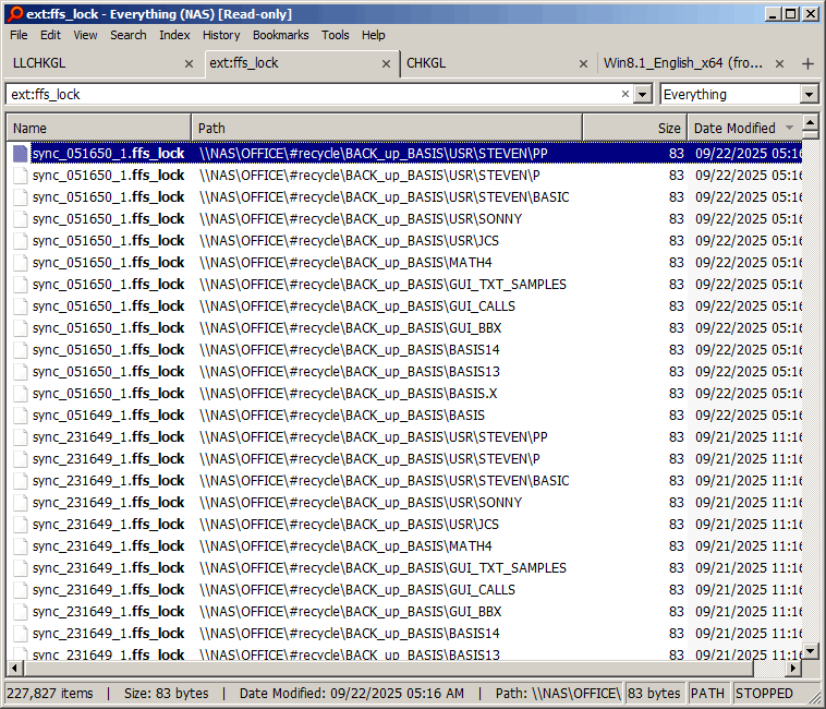

If you're using Everything (& everyone should be),
you can simply search for 'ext:ffs_lock',
select them all, & Shift+DEL.
Everything - https://www.voidtools.com/
Or you could create a .bat file, using DEL (but you'd have to know just where to look...).
. (Seems my NAS sees these files, & when they are "deleted", they end up in its' #recycle bin.
[They only exist there, nowhere else.] [So] not a big deal, even if it has happened 227,827 times ;-).)
