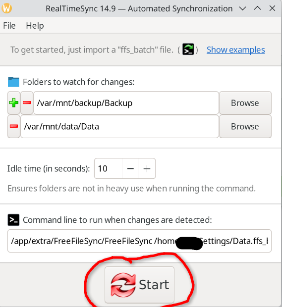

I have aurora Linux (Atomic, KDE) and set up the batch file to sunc folder. I also set up realsync to start the batchfile. But when i boot up the system, I have to manually hit " Start". Once i do it, it works fine and automatically syncs during that session. But at next boot, i have to hot " start" again. Here is what I see when the system boots up:
In order for it to sync, I have to hit " start"

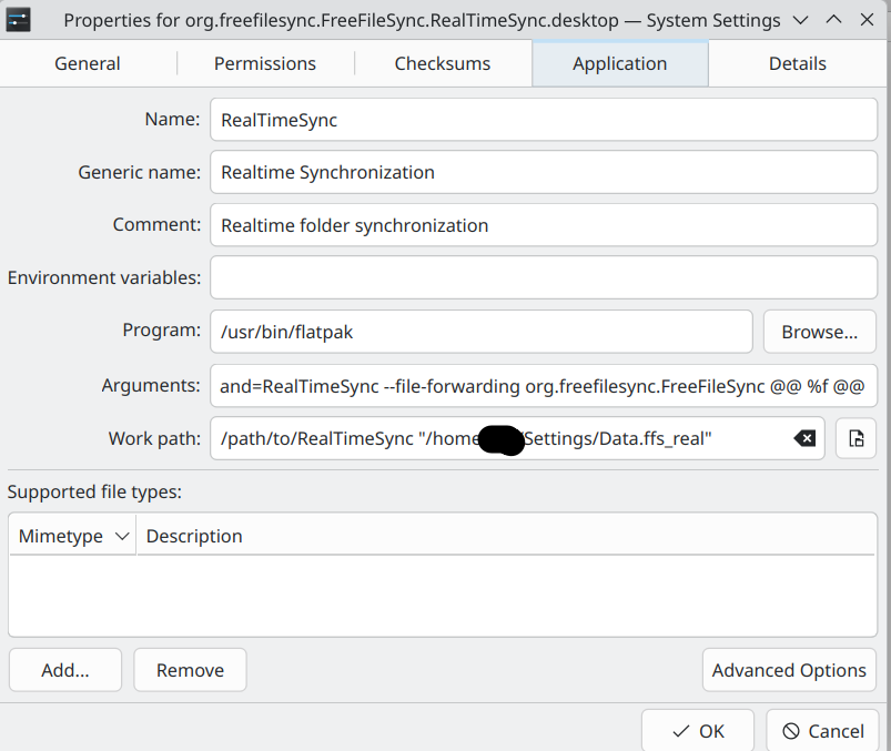

In order to automate that ant not having to hit start, I changed these settings in KDE autostart:
I edited the workpath based on what i found in some thread...
Maybe I mis-understood, or there is something wrong. What exactly do i need to do to make this start automatically?
Posts: 4941
the program to run is RTS and the argument you pass to it is the .ffs_real config

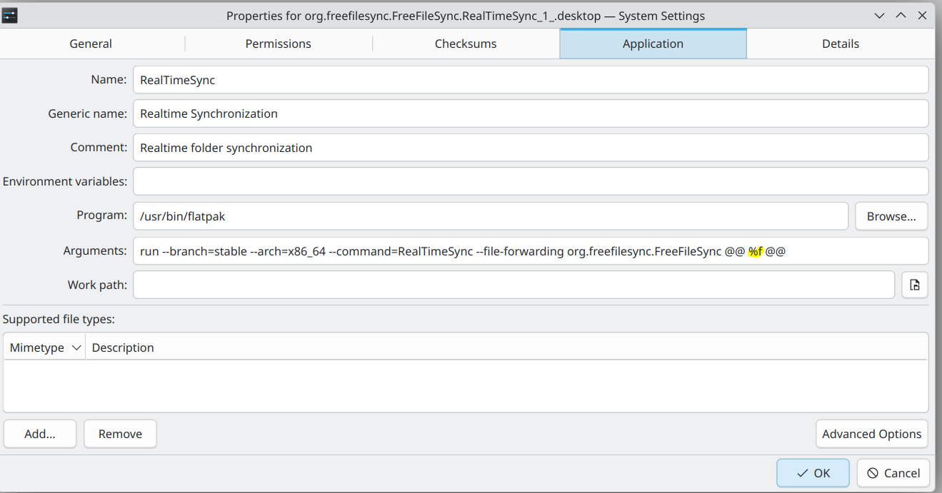

Here is how it looks out of the box:

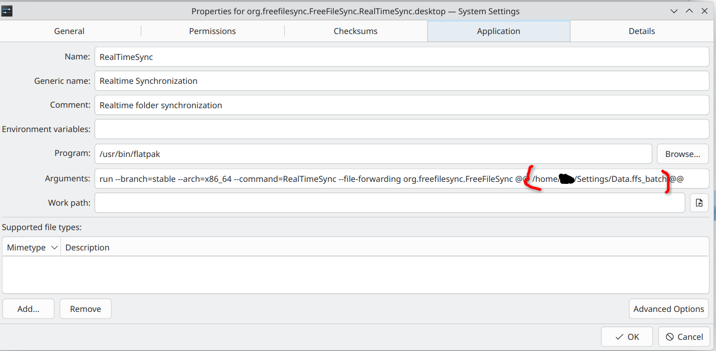

You need to delete the "%f" and at that exact location insert the location of the "ffs_batch" file:
That's it and works.
