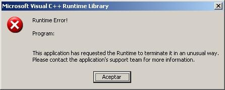

Failed, I launched it and just get this error when the comparison finished and is gonig to show the comparison result window.
It is a 6.646.000 files job.
Is the first time I get this error.

It was manual. I relaunched it as a ffs_batch job.
It takes one hour to compare.
Could it be an out of memory?

Don't think so. Maybe it was casual.
Now it finished comparing and is copying....
