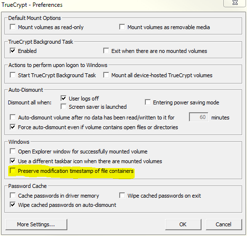

You probably haven't unchecked "Preserve modification timestamp of file containers"

Yes it is checked.
Thanks a lot!
I'll try again with it unchecked. Will let you know...

It works after unchecking!
Thanks a lot!
