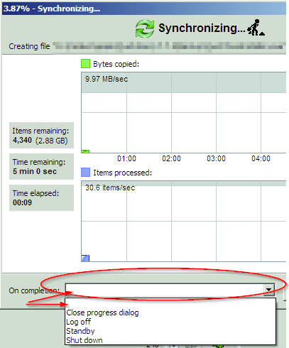

- Posts: 8
- Joined: 5 Feb 2016
I downloaded your new version 7.9 today and installed it. I added the line <NotificationSound SyncComplete="gong.wav"/> after the LastSyncLogSizeMax line and after the Sync finished I still did not hear anything. I did notice that the Synch progress window is no longer showing a Blank Option under the On completion choices. It used to be choices of: Blank, Close progress dialog, Log Off, Standby and Shut down. Is the blank option what made the program Play the sound effect? I have attached a screenshot of the On Completion choices showing the missing Blank choice.
Thanks.
Thanks.
- On Completion screenshot
- 163308-000129.png (3.87 KiB) Viewed 3923 times
- Posts: 8
Update:
Strange Observation: If I backspace over the word Close progress dialog and leave it blank, it will play sound but I had reinstalled v7.3 to test this since it appears I could not get sound to play from v7.4 to v7.9. For whatever reason, I think the On completion box needs to be blank in order to hear a sound?
Thanks.
Thanks.

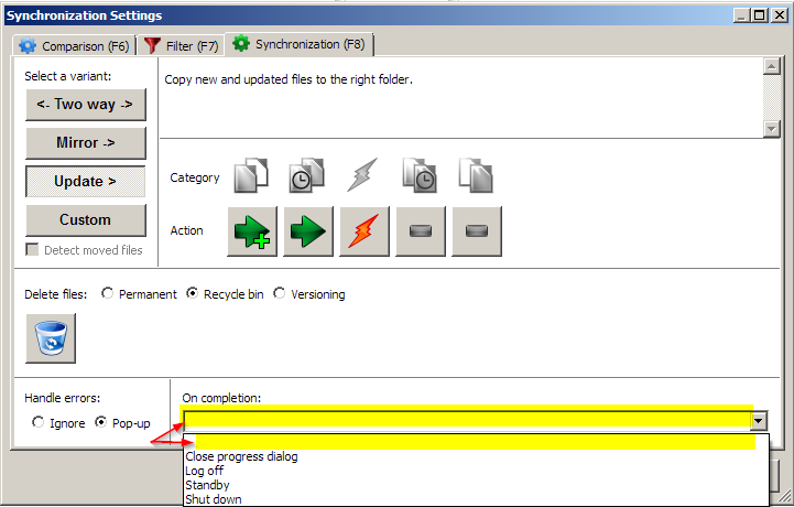

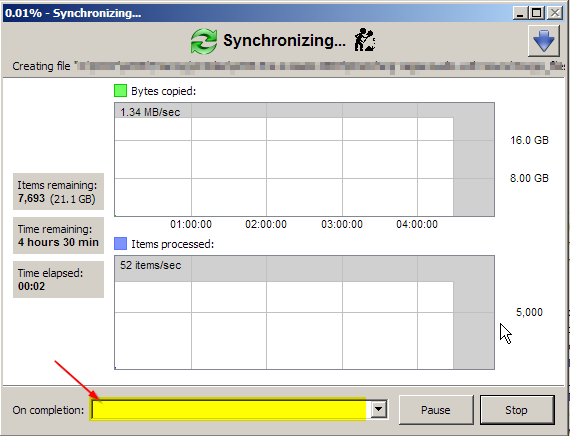

- Posts: 8
I did an uninstall of FFS, then I installed FFS v7.3. I have attached a screenshot of the On completion box showing where there is a "blank" space. I'm assuming this is what causes FFS to play a sound? Even under the Synchronization Settings, the On completion box shows the "blank" space.
Please let me know if you need any more screenshots.
Thanks.
Thanks.
- 135324-000136.png (35.47 KiB) Viewed 3908 times
- 135020-000135.png (26.46 KiB) Viewed 3908 times
- Posts: 7524
If you set "On completion" to anything different than "Close progress dialog" you should hear the sound, unless you're running a ffs_batch.
viewtopic.php?t=1792&p=9653#p7196
- Posts: 8
Thanks! I could not get that blank option unless I removed the previous version first. I now have sound. Thanks again for re-adding this useful feature back into your program.
