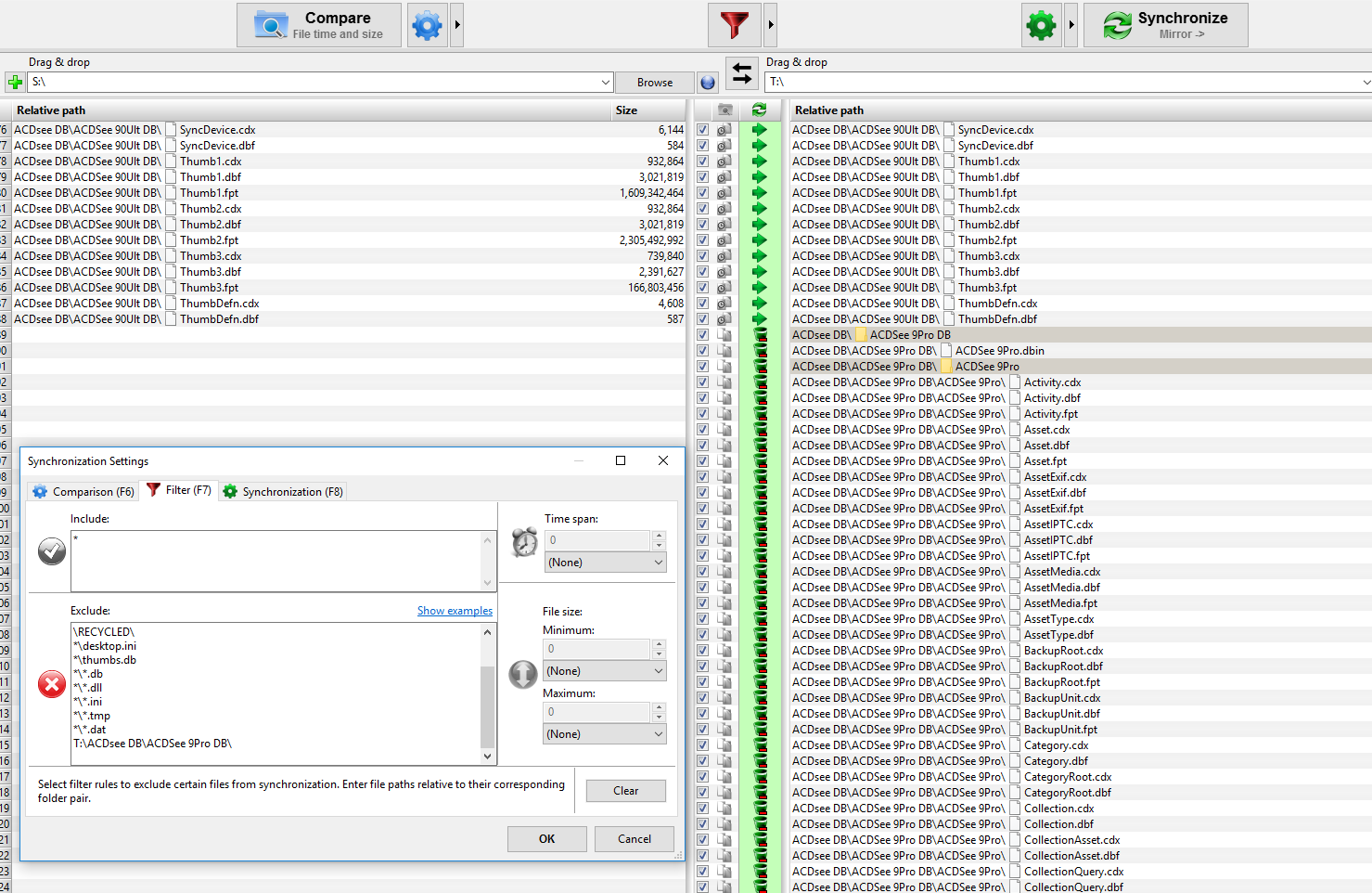

I seem to have the opposite problem - I want the folder on right to be untouched by mirror, but FFS wants to delete it. Perhaps I've entered the exclusion incorrectly. Can you suggest what I've done wrong from the attached screen shot?
- Joined: 11 Sep 2016
Hi, you press F8 and then you press the UPDATE button.
With this option you have untouched the right side, and only update that files.
