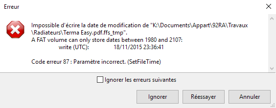

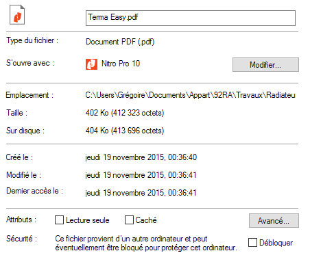

All dates (created , write, accessed) for this file are 2016. I do not understand
Can you post a few screenshots comparing what is shown in FFS with Explorer?
- Posts: 9
- Joined: 3 Mar 2016
Here are the screenshots. Quite self explanatory but it's in French though so tell me if you need translation.
- Posts: 9
Please note that 18/11/2015 23:36:41 UTC = 19/11/2015 00:36:41 Paris time (just to explain why we have a difference)

The problem is not due to an invalid date, but caused by the WebDav drive not supporting modification times. The error message was misleading, though and I've fixed it to not warn about the date in this case.Here are the screenshots. Quite self explanatory but it's in French though so tell me if you need translation.Gpx
Unlike FFS, Windows Explorer ignores failure to write modification times.I do not have issue when i copy/paste files from C: to K: in Windows ExplorerGpx
